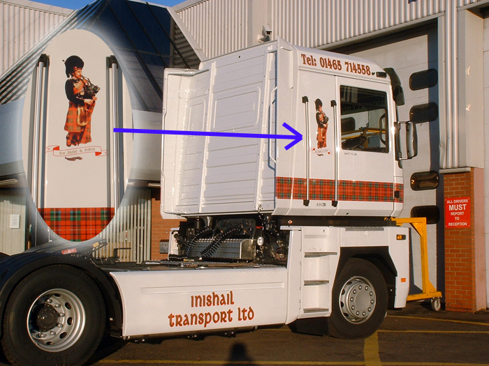

    Here is a Renault Magnum with some digital prints with a scottish theme.
    Prints were done on clear digital media with lamination,
    using 54″ Grenadier.
    The rest of the text was done using red and gold 751c vinyls.
    Fitting was pretty easy as it was mostly all flat panels with exception to corners and recessed areas behind the bars on the sides.
    Customer was delighted.
    Andy

    October 30, 2005 at 12:07 pm
    looks great.
    the translucent effect on the clear not a problem then? Or did you print a higher % of ink on the clear.
    Never have much luck printing on clear. Always look insipid
    well done mate
  • Andrew Ritchie
    October 30, 2005 at 1:03 pm
    No nothing special was done to profiles or ink %, as the cab of the truck was white so the colour was really vibrant.
    The tartan stripe faded out on the front of the vehicle and I knew if I used the white digital media it would stand out on the white body.
    In all it looked really smart, the new 751c Gold also looks great as its more glittery/ metallic now.
    Andy
