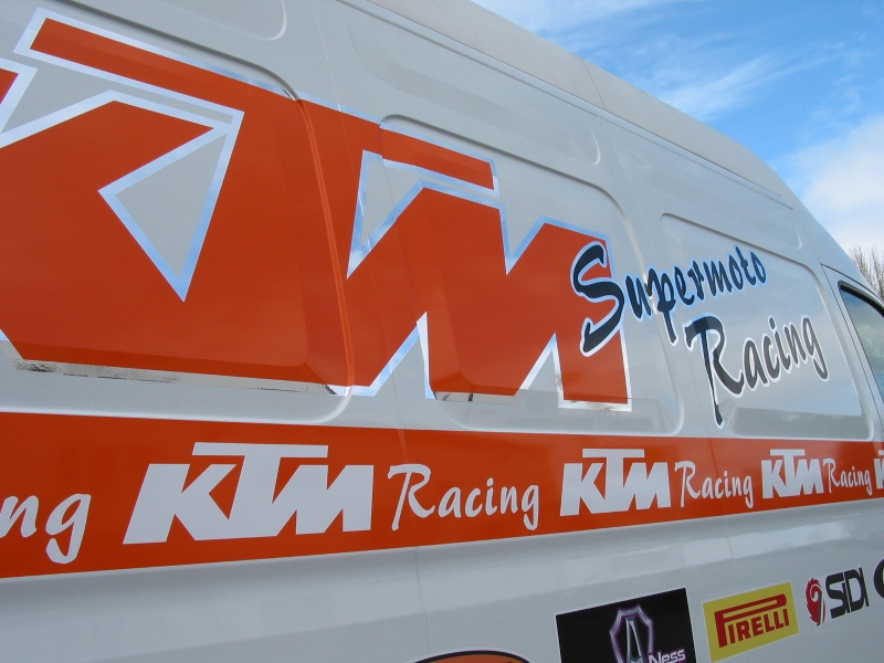

    Hi All
    Not posted anything for a while – have been too busy – long may it continue!
    Finished this van on Friday – pitty it had clouded over before I took the piccies, the orange and chrome looked superb in bright sunshine.
    Macky

  • Dave Bruce
    2 April 2006 at 18:34
    Nice work Macky, did you put the chrome under the red or just as an outline, just askin ‘cos you got some wee double curves going on there, and I wouldn’t fancy getting the chrom to go round them.
  • David McDonald
    2 April 2006 at 18:41
    Hi Dave
    The chrome outline includes backing and it wasn’t too bad getting it across the double curves, although I did cut the chrome at the sharp edges of the panel recesses – no way to get this stuff round those angles.
    Macky

  • valegraphics
    2 April 2006 at 19:58
    Love it macky. Whats make is the chrome?
    Matt

  • David McDonald
    3 April 2006 at 08:32
    Hi Matt
    The chrome is only 1 to 2 year stuff, DS50 from APS. I can guarantee within a year he’ll want it all stripping and replacing with another brand so long term durability not a problem. This is already the 2nd time I’ve completely stripped and re-done this van. Last design I used 13 metres of R-Tape (Coburn) 7-year chrome at nearly £13 a metre – best chrome I’ve ever used but not really worth it for 6 months! The APS stuff was a lot cheaper.
    Thanks all for comments
    Macky
