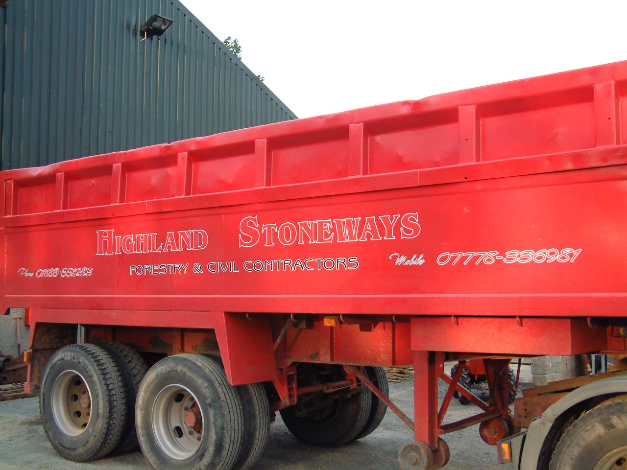

  • Gordon Forbes
    August 31, 2005 at 1:36 am
    I posted the wrong pic here the outline is actually white ooopppsss.
    I so far haven’t had a problem with the chrome at all needs a bit more pressure to cut
    I have some of the 2 year stuff just to try it and then bought 5 year and this is good but expensive I have another to post digital print and chrome once I get pics I will post. The lettering had shadows cut into it and these were very small and had no problems with the 5 year stuff.

  • Chris Wool
    August 31, 2005 at 8:53 am
    Derek i think you are using the thicker chrome vinyl which because it has been rolled up for so long when flattened to go through the cutter the vinyl lifts on its backing paper most people are probably now using the thinner stuff.
    goop trailer looks nice how do you get away with thinner outlines cos of the way they clean these things i would expect it to be blown off.

    August 31, 2005 at 10:56 am
    quote Jill Marie Welsh:
    I can always see the reflection of my face as I weed.
    I’d prefer your pretty reflection than mine Jill. 😮
    I don’t work with chrome at all. I also have issues with the stuff creasing, wether i use the thin or thicker stuff.
    The only stuff I’ll consider is the new R-Tape stuff, but that creases too if you put it over the heaters on the soljet. Have to print it cold to work properly.
    Goop, I had the same thought as Chris, surely the signs get damaged easier in the thin outline style?
    Well done tho
  • Gordon Forbes
    August 31, 2005 at 4:18 pm
    It isnt an outline its red over white This text was actually designed for another trailer a large tipper and the day I was due to do it the driver tipped it while tipping a load of hardcore and totally wrote it off almost wrote the unit off as well.
    So he wanted to use the same lettering on the replacement truck not the same colour though but it works all the same.
    I tried printing on the chrome with the cadet only used the one profile and it didn’t do to well sort of sat on top instaed of the usual burning in.
