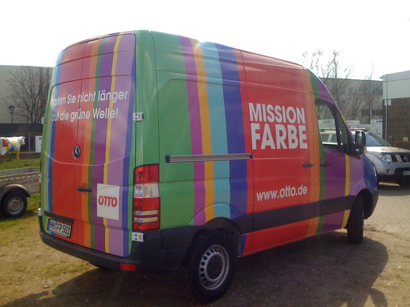

  • Oliver Röhler
    April 6, 2008 at 11:14 am
    nice work indeed!
    i like the "american way" of design… it is allways fresh… nice.
    in the attachment you see a sprinter (new: crafter) we wrapped here in hamburg.
    the big challenge was to keep the design with the vertical stripes…
    very difficult in the creases and the convex parts of the car.
    the roof is very hard work, you need a lot of time to temper all the creases.
    material on the body: avery 1900
    roof: 1005 ea RS
    -oliver-

    Oliver, congrats on that Sprinter! How long does it take for you to wrap a Sprinter (without the roof), or a Smart, a Mini Cooper?
    Cheers,
    Bart
    April 7, 2008 at 5:53 pm
    very nice work Oliver thanks for showing
  • Oliver Röhler
    April 7, 2008 at 10:37 pm
    :thanks: 🙂
    sprinter without roof: ~ 12 hours
    smart: ~ 6 hours
    mini cooper: ~ 6 hours
    digital printed material without "easy apply"
    a simple color change can be a lot of more work.. in this case you can count ~ 2 hours more..
    btw.: the roof of this sprinter needs 1 hour to temper! (good for me to have a trainee :clap2: )

  • Oliver Röhler
    April 7, 2008 at 11:02 pm
    quote Robert Lambie:
    nice work mate… not keen on the design but it will certainly be remembered.
    was there any specific reason you did not use ez apply on this vehicle?
    i´m only the wrapper… (where is the car-wrapper-emoticon ?)
    design was from the customer…
    yes there is a reason: durability!
    these sprinters (3) should run a long time and the customer ask for first-class quality.
    they ask 5 companys if they could do the job… 4 of them say NO
    OT: the original avatar picture was better… in my mind…
    April 7, 2008 at 11:06 pm
    quote Oliver Röhler:
    do you not rate the ez apply wrap vinyls for long term work or just not for this type of vehicle?
    i have two of those sprinters to part wrap in the next week or so… ive heard a few folk now say that there can be issues with the recessed areas. just wondering if you have heard the same?
    thank you for taking the time to load your pictures. much appreciated.
  • Oliver Röhler
    April 7, 2008 at 11:19 pm
    i am an avery trainer… (amongst others) i work a lot with this materials.. and this is a result of my experience… if there are extreme creases, so i don´t use easy apply.
    1900 is easy to use and works perfect…
    btw.: the 1900 needs to be really dry after printing! (minimum 36h before laminate) then it works really fine…
    April 7, 2008 at 11:24 pm
    yes, i agree with you on that with regards to the ez-apply. i.e. not good for sharp and deep recessed areas.
  • Bart Van Wassenhove
    April 8, 2008 at 7:57 am
    @ Oliver:
    is that the time with 2 or 1 man??? You’re fast!
  • Oliver Röhler
    April 8, 2008 at 8:27 am
    times are for 1 man.
    for the big parts (roof and side part) i need for 10 minutes a second hand to fix them…
    but the main job is done by 1 person.
    i only make car-wraps, nothing else… maybe this explains my times…
