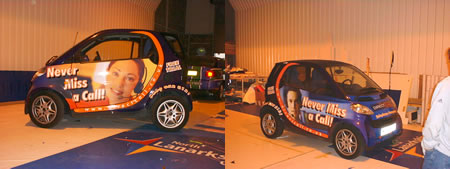

  • popcornpro
    December 10, 2003 at 4:48 pm
    Thanks for the feedback folks…
    Robert said: from what i can see i think you have wondered with the coachline text a little
    Ahhh… there are lines on all three panels, so I followed these but I would have rather they were more equally spaced.
    Overlay? Yes I overlayed the logo on top of the background “ghost”… It wend down dry and I used Oracle 751 which seemed managable… the recesses went in fine and I put a cut to the outer edge of the recess as suggested within.
    Taking ages… yea, it did take ages but in all fairness I was pretty picky. The only part that took so long were the ghost wraps over the back panels. And no, I made next to zilch out of it… I have another business and this is something I have been interested in for a couple of years but not been in a position to try.
    I went down to see Mike Brown during the summer and he gave me some great training in preparation and application. This job was more like a favour to an existing customer and something to show other customers.
    Anyway, thanks for all the pointers. I have included a recent project but I was only responsible for design and outsourced the print and application… this is what I am aiming for!
