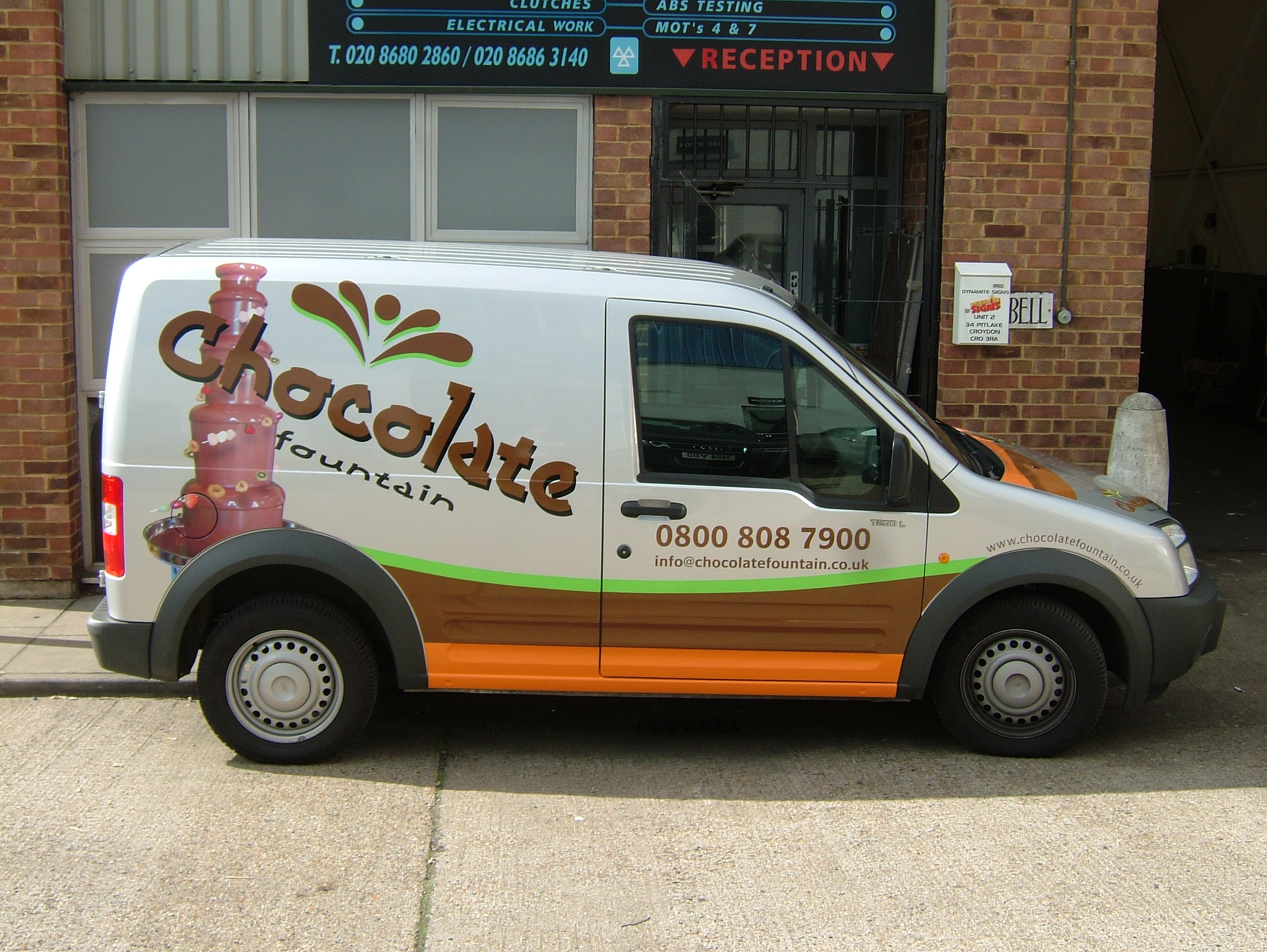

    this is a job that we did this week
    i did not do the design the customer told me how he wanted it to look and its a copy of the web site design
    i like the design and the finished job looked very good
    thanks to john from rainbow graphics for the print work
    rich
    oh just for rob all done dry !!!
    rich

    Damm fine job, well done! How long did that take Rich.
    ps. What the hell are those chocolate fountains all about :-?, if ever I’ve seen a 5 minute wonder it’s those. They were on telly this morning as the next gadget people will buy and not use after a couple of goes.
    Christ sake don’t tell your customer that though, well maybe after hes paid you.
  • Richard Urquhart
    September 29, 2006 at 4:46 pm
    he is doing well business for him is great
    i took longer that i thought the lower vinyl was hard work to fit but looked good
    one complete day from from start to finish
    i didnt rush it just took my time fiarst side took longer
    rich

    nice work Rich, what vinyls did you use in the end. . Cast ?

    i used mactac 9800 on the lower I’m hoping that the vinyl will not pop out due to the swage lines not being that deep and very smooth i hope any way !!
    when fitting the vinyl went it to the recesses very well i did not have to heat vinyl but after i did heat very well
    i did a few transits for a company 3 years ago going right through the side at an angle used mac tac 9800 and the vans still look great today no popping at all so fingers crossed
    the print work was on wrap material
    rich

    Hi rich
    Very nice job mate, well done!
    Don’t worry about the 9800 pulling from those recesses; it will be fine, especially as you have went over it with a heat gun. There wasn’t any need for the wrap material on the image either… again it will be fine… I used 9800 for many years before switching to oracal and used it on far more demanding recesses than that and still it worked spot on. So I am sure all will be good.
    I like the idea of the padded mat for working on, nice one… if I have allot of vinyl work on the lower sections of a van I some how still manage to fit it standing up! 😳 :lol1:
    Nah, seriously though ill just cut a bit about 6’x 2’ of thick cardboard from our correx delivery box/packaging plank my backside on that. Your idea looks far better though…
    Constructive crit:
    On the sides I would have carried the colours flowing along the lower section onto the front wing “after” the wheel arch. And also before the wheel arch at the back… carrying that around the back to meet the other side of the van.
    I would have used a silver shadow on the “name” because the back shadow is merging with the brown and closing up the letters. Silver on silver would be subtle but enough to give the effect of the name casting a shadow…
    On the rear I would have reduced the web address to only cover the orange section as opposed to crossing the doors and the printed image.
    All in all the van design works well for the type of thing its is promoting, well done and thank you for taking the time to post your work.

    john did you notice i left the top part of the skewers off !!
    just didn’t look right so how
    we did our best with that file but as we know there were some spot the differences
    thanks again mate
    rich
    oh one other thing john hang on to the file mate we will have a few more prints needed some time for another van
    rich

    quote Richard Urquhart:
    rich
    Yes, i was wondering if you would take them off, or should i say alter the "Graphic Designers" work, funny how they always think they know best.
