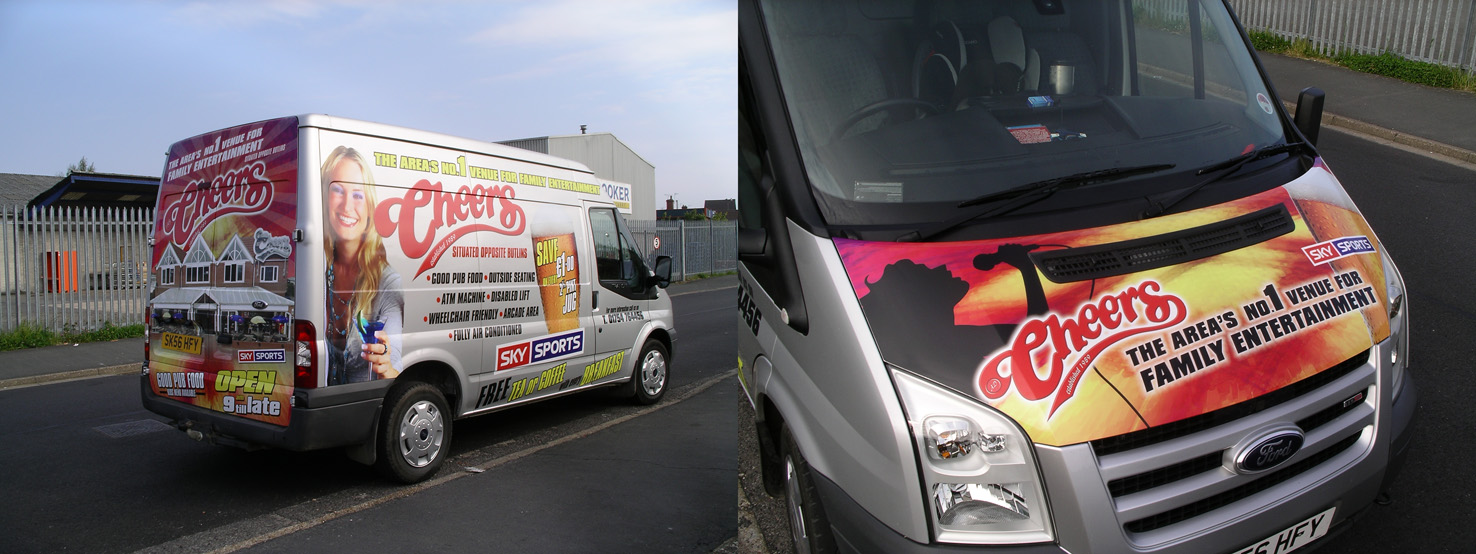

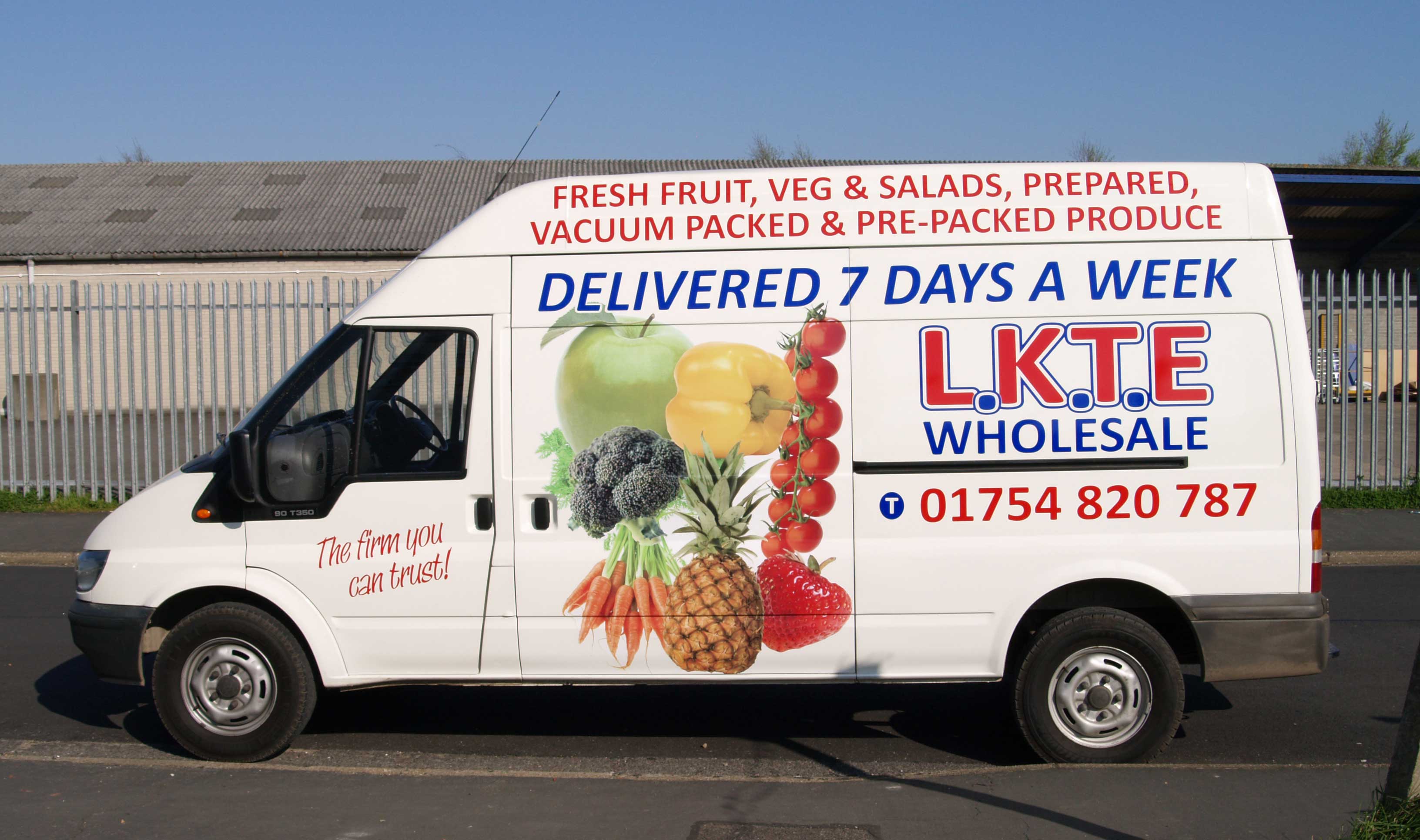

    Not posted in here for a long time, we did a couple of vehicles last week that had a bit of colour so i thought i’d post them.
    The Cheers van (rear) is not to my liking, we had a good design for the rear doors but the customer wanted a picture of the pub.

    They look stunning – well done. 😀
    An excellent combination of part wrapping, digital print and cut and cut vinyl.
