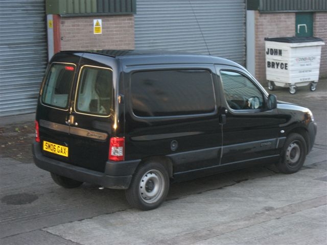

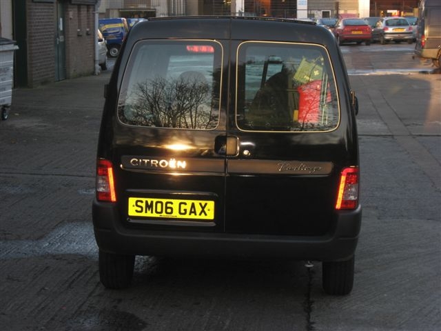

    Hi everyone,
    no more white van man. Another customer with a contract lease van in white but wanted it black to match the rest of there fleet. The last van i wrapped for this customer was done with Mactac Macfleet but they didn’t like the satin finish and i found it too brittle even in a heated workshop so i wrapped this one with Mactac 9800 pro.
    Decals done by another sign compay. (hot)

    from the pictures you look like you have done a great job mate… well done!
    i really like mactac 9800 used it for many years but im a bit uneasy on the deep panel recesss on the sides. what i mean is "will they pop?" i know macfleet would eat any contour a van can throw at it but the 9800 has limitations.
    anyway… excellent job mate! 😀

    Thanks Robert, you are right about the Macfleet it works into recesses great but tares far to easy. I am confident that the 9800 will not pop because of the way i prepared the recesses and the way i shrinked them into shape and a bit of afterburning. It’s all about stretching the vinyl the right way as you know.
