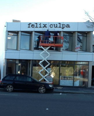

    We have got 5m 8ft x 2 ft tower which gets you 6.5m practical working height with outriggers and have used for years inside and outside in awkward situations etc we can also split it down and with an extra set of wheels build two towers side by side for lower level work very useful. if we need cherry picker or scissor lift we hire in for the job that way we get the machine we really need and as we cover quite an area geographically we can usually get it delivered to site leaving us with a whole van for signs.
    Agree with Rob they ar fairly useless on the high street. Good for pub work getting over projecting roofs conservatories etc and for Retail park.
    Scissor lifts also good but some machines very heavy again no good on pavements as risk damage to pavements unless you board them to spread load a little.

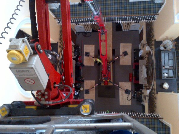

    I used this 25 metre bad boy at Inveraray Castle last year. Its on tracks and can fit through a 1 metre wide opening

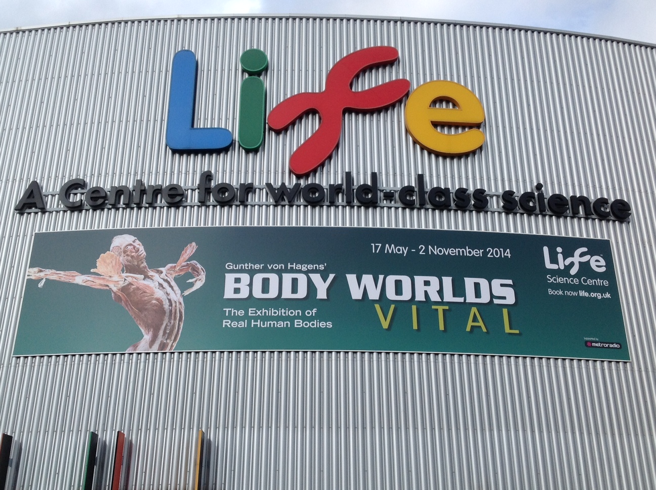

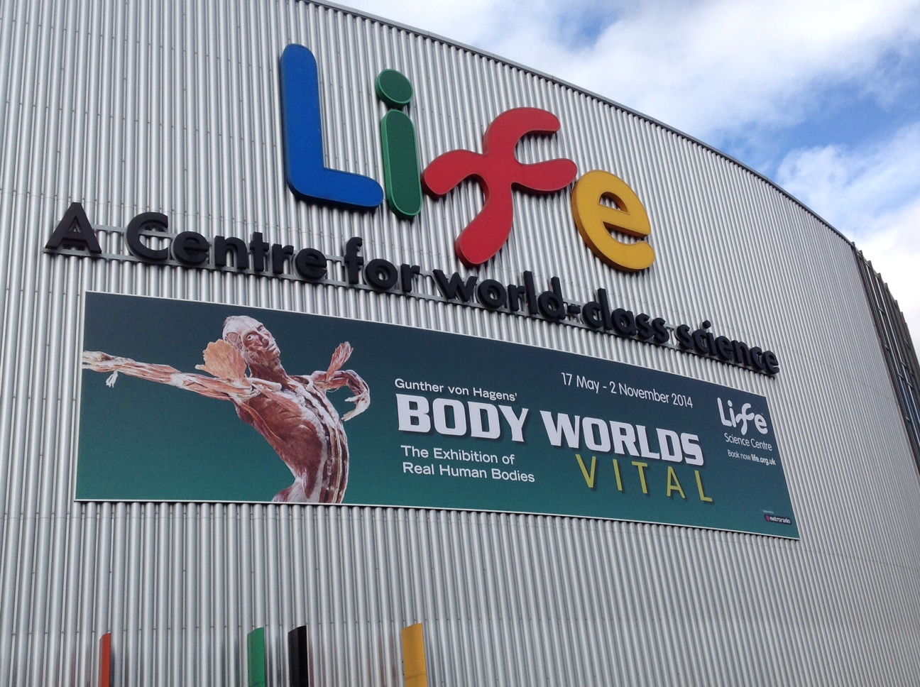

    6 February 2014 at 19:27
    todays install 14 x 3 metres it got dark the picture posted the banner is just pinned ready for stretching will post one tomorrow of finished and trimmed
    ideal job for the cherry picker
    derek

    finished pics bit of a tricky one with the curev of the building but worked out ok size is approx 14 x 3 metres
    derek
  • Derek Heron
    9 February 2014 at 09:53
    finished pictures attached
