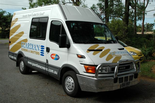

    Hi friends,
    Just thought I would upload my latest job(s). 2 Identical Ivecos, took me two days each all by myself.
    Customers dropped off the vehicles unwashed – I hate that!!
    Customer had the design done by a graphic design company that had no idea how difficult this would be (or didn’t care.)

    They look so good I’ve kept them for reference. Excellent one man fitting too.

    Top job Shane 😀 Looks really good!
    Out of interest, what made you choose 851 for that job, most of it looks as if 751 would’ve done the job?

    hi Shane, another iveco? 😮 bet you were NOT glad to see them after the large digi printed one you did? :lol1:
    anyway, vans look great, well fitted to from what i can see. 😉
    how are you finding 851?
    I HAVE SOME TO PLAY WITH BUT HAVEN’T REALLY HAD MUCH CHANCE TO GIVE IT A REAL caps 😕 test… maybe i should do a product test on it soon? 🙄
    anyway, how does it feel to work with, how well does it stretch?
    like dewi says, 751 would (& does) cope well on ivecos, reason i know is we do them lots for a large contract we have and i mould the 751 into the recesses without any bother. been doing that 2 years and haven’t had a come back yet. (touch wood :o)
    anyway, if 751 does it, 851 will eat and spit the job 😉

    I used 851 because it is a cast primarily. Have had a few ‘popping’ incidents with 751 (although my own vehicle has been done with it) so I was a bit hesitant.
    Until I discovered Oracal, I was a 3M 7725 user, and a 3M Control Tac user.
    I was happy with the 851’s application, but I must be honest and say that I think it falls a bit short on application compared to 7725. 😕
    It certainly does not stretch as easily over the deepest indents, (the top recess on the Iveco especially) and in fact it tore when doing the old wet finger trick. 7725 would have worked in this situation. A cut and shunt fixed it tho. When you heat it to try and conform areas, it shrivels instead of shrinks too, again, I can only compare this to 7725. 😥
    No doubt it is what you get used to, and I certainly would not right it off, but by comparison to 751 I think it is certainly easier to use and apply. 🙂
    I have a sample here (don’t tell anyone as it is a secret!) of the new 751 cast material. I have tested it against jobs that I normally used 7725 for, and I am reasonably confident to predict that it is exactly the same face stock. It feels like 7725, it looks like 7725, it weeds like 7725 – me thinks it is 7725. 😎

    Reason I asked originally Shane is, like Robert, I’ve used 751 on quite deep recesses without any real hassles. I did have to work at it, but I’ve checked on the van recently and its as good as the day I fitted it.
    As you say though, the price difference between the two vinyls, 751 & 851, isn’t massive. Just wondered why you’d gone for 851.
