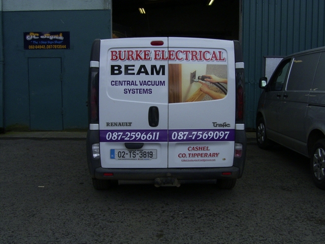

    Just thought I’ld show you all this one. I’ve done 5 vans for this customer, but this is the first with full colour graphics. The prints were done by Eddie Cotter on his Cadet. Can’t Wait to get my own one !:-? πŸ˜•

    very nice, are the prints laminated or straight from the printer.

    Thanks. They’re straight from the printer. The customer changes his vans every year so they won’t be on any longer. If they were done on a versa cam I’ld definatly laminate them. The Cadet prints can stand up to a fair bit of abuse.

    It’s a deceptively simple looking job but how long did it take you to apply?
    The purple stripe along the sides, did you apply then cut around the wheel arch?

    Thanks guys. The job itself took five hours to cut weed and apply. and you’re right about the stripe. its applied and cut around the arches.

    Orville how do you cut around the arches without cutting into the paintwork.

    If we have a batch of vans to do then we will make a stripe with a cut-out for the wheelarches, handles, locks etc etc. On the other hand, if there’s not enough volume to warrant the time then we just cut by hand. It’s easy enough to cut the vinyl and not the paint, easier to do than to explain, but it is more by feel than anything else.
    You must never, never cut the paint because it will rust in short order and it will be painfully obvious whose fault it is. If a mistake does happen then a bit of clear nail varnish works wonders in re-sealing.

    I do a lot of fleet work, and hand cut large logos and letters all the time. My secret? Always use a new blade, and have a very light hand. You’ll know when to change the blade, when your hand presure is the same and the cuts are not coming away. You need a fresh edge to get a clean cut with light pressure. Never press on the blade to cut. A new blade egde will do it easily, without any pressure.

    Cutting on the van is easy if you use a new blade and be VERY careful. I got a lot of practice by doing rally cars.Doing one off jobs doesn’t warrant the extra time spent creating cut outs .

    I’m talking about a Swan Morton 10A surgical blade, these little blighters will cut through vinyl & paintwork far to easily, if your a fan of the Swan Morton blade I would say make a few cuts on a scrap bit of vinyl to dull it before cutting on a vehicle.

    Sorry Guys, I don’t know what a Swan Surgical Blade is. I am talking about the bog standard blades that have about 10 segments, that you can keep breaking off to get a new edge.
    I have hand cut one off signs, 3 metres in length, on new buses, without damaging the paint work.
    It really is easy once you get your head around it. :lol1:
