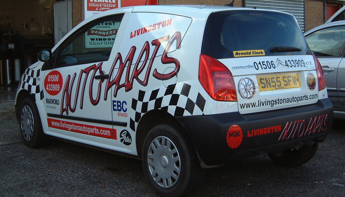

    I did this van today. The logo was created using Signlab 7.1 eyecandy, printed, laminated and then contour cut. Some of the other logos were also print and cut. The rest was done using vinyl.

    What vehicle template software do you use? and how much would you charge for a job like that?

    looks good phil, do you laminate the "autoparts" section? if so how is this done.

    Thanks for the feedback.
    We’re doing two of these vans at £270 ea. + VAT.
    I use Impact vehicle library outlines for the template.
    The printed "Autoparts" were laminated using a clear vinyl (I do this by hand 24hrs after printing to allow time for the print to dry – the clear vinyl laminate is applied "wet" then left to dry out before it is then contour cut).
