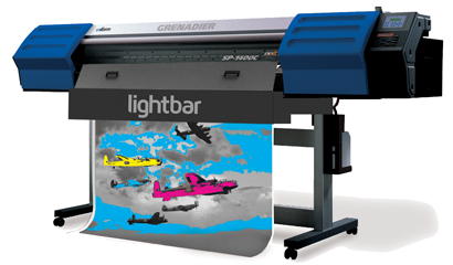

    Well, I thought I would make a post for now because i have taken the plunge and had a UV Lightbar from Colourific installed on my machine.
    I have been speaking with the guys from Colorific and pondering over this for some tim,e and decided to give it a go…
    We currently run two Roland Solvent roll-to-roll machines and a HP Latex, so we moved the slower older printer “Grenadier” onto UV Inks with a Lightbar, with the other faster Roland kept on solvent inks.
    “The Lightbar” is basically a conversion kit that can be fitted to some of the most common printers available today.
    “In short” your Ink gets flushed from your current machine, and the Ink is changed to UV ink.
    A Bar along the front of your current machine is screwed on, which houses a UV Lamp.
    As your print media spills out the front of your machine and passes the UV bar, the ink is instantly dried/cured and ready for use.
    Our Grenadier has to be about 10 years old, so it’s done us proud and has paid itself many times. The main purpose of keeping it is basically its a Roland, a workhorse and one of the best brand names our company has ever invested in. The machine just keeps going… the main key tool on this machine for us is its on-board cutting facility for contour cut graphics and the like. we do lots of this type of work so it is important we have it. (yes i know newer models are available, but why replace it if its not broken? 😉
    anyway, a gripe i have for the ink is always drying time before laminating or before being able to actually apply graphics. As most will know, any solvent ink must out-gas even before use, “not only” before laminating.
    If you use a solvent print fresh out the machine, it is like trying to apply cling-film with super-glue on the back. just isn’t going to happen!
    Now using UV inks, this is easily done…
    we have a very busy workplace and the time window to get graphics out the door is closing more and more… Also, the new UV inks should give our machine a new lease of life as its a cleaner option without any smell/odour at all.
    My understanding is that there are several options on how a lightbar can be installed. i am not clued up on them all so best asking the options available and the machines it can be fitted to if interested.
    Well it’s been only 48 hours since its installation and already we are seeing turnaround times of our graphics improving. with dozens of signs printed in the morning, applied to boards and signs and being loaded on the van at lunchtime.
    we are also seeing colour output vibrancy improving on certain colours/tones etc. This isn’t necessarily my take on it but Andrews, who we have running the machine. could that be the profiling etc i don’t know, but its just another improvement from our old machine.
    I will keep this thread updated with anything significant we come across from time to time as i plan really pushing our machine to find its pros/cons…

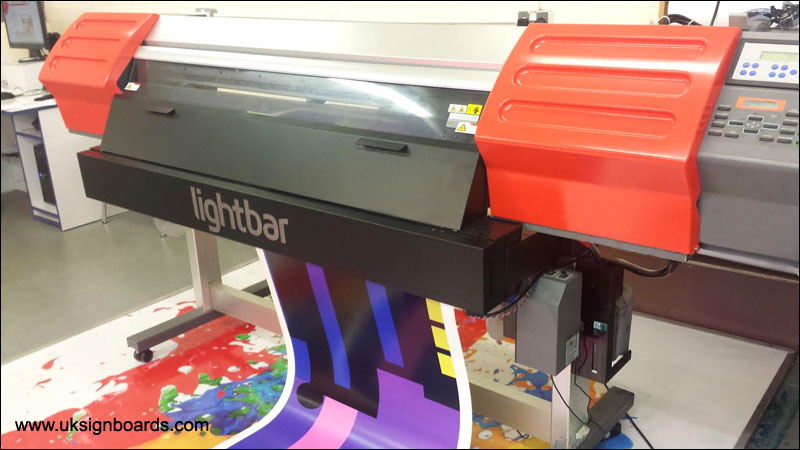

    I would be interested to see an actual picture of your conversion Rob
    Simon:

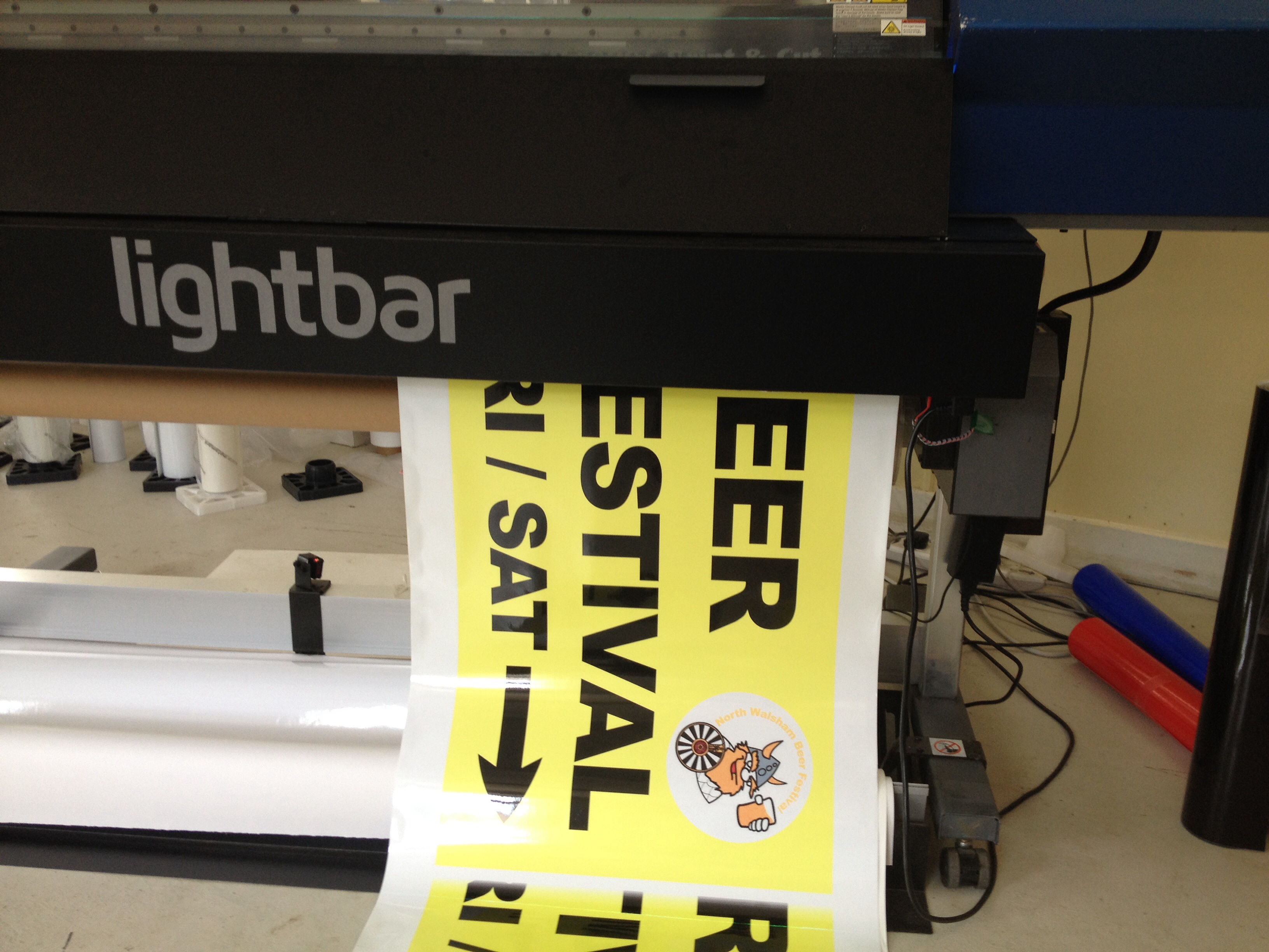

    Please see the attched picture of our 10 year Old Printer converted to UV Lightbar Inks.
    sorry the pictures not the best, took it on my phone. shakey hand and all that! 😀
    as you can see it looks just the same as the picture you see in my initial post with the exception of the take-up roll visible in my picture and not in theirs.
    the media being printed on in the picture is Neschen wallpaper
    hope this helps…

    Thanks Rob for the explaination of what the ‘lightbar’ was. Keep seeing it mentioned on the threads and didnt have a clue.
    It looks quite a straight forward conversion from solvent to UV inks.

    Also, is the UV printed surface tougher than solvent? ie will it last longer if unlaminated?
    Thanks for the pic. I am amazed by how straightforward it seems to be.
    I would have thought the whole internal gubbins would need replacing – heads, pipes, filters .
    This kit seems to be almost a bolt on addition!

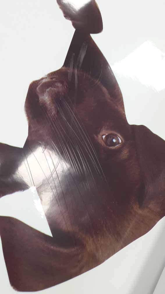

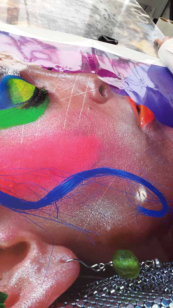

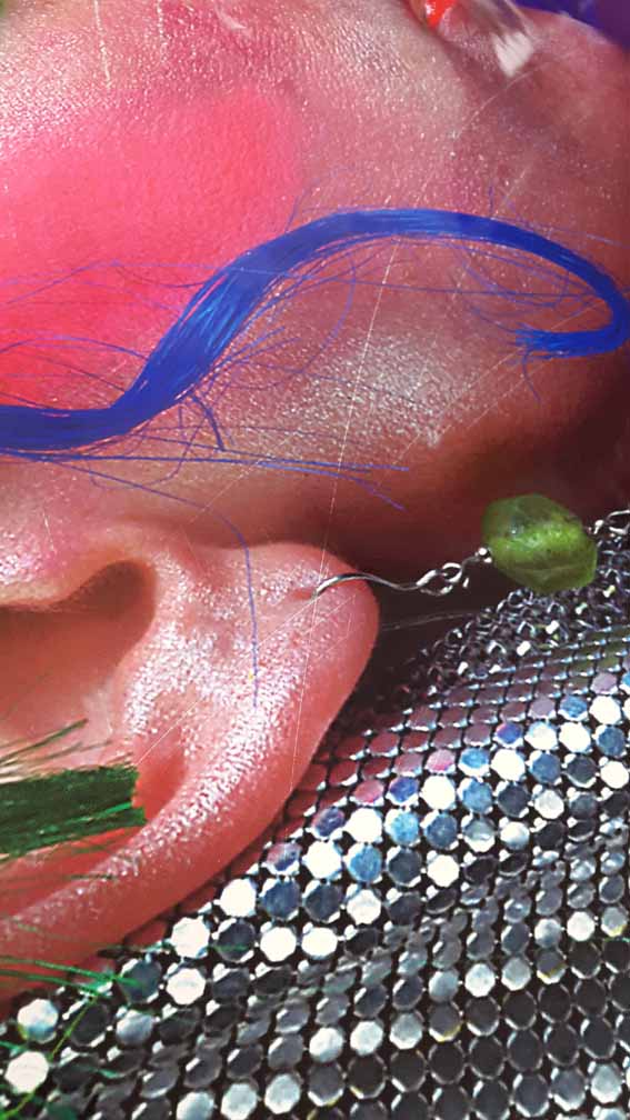

    Dave, I did a ‘scrunch, scrape, scratch and vigorous IPA rub’ check, and found that the ink did not move one iota. Screwed the vinyl up, off the backing paper, so was stuck to itself, and pulled it out again, and it was fine. No cracking or failure that I could see, but I will continue to test it over the next few weeks.
    Thee is a little lump effect on the surface, but no more than I get with Eco Solvent inks from the Versacamm, and I stretched a small area and it didn’t break.
    Obviously I am going to have to put it all through its paces, and will give feed-back if interested. It has been a long day today, need to have a play over the next few days, as it is a different machine to the one I have become used to., but I am looking forward to seeing how I get on.

    So it has been six weeks since our Colorific UV lightbar has been installed and our guys are more than used to working with it now. I asked Andrew again if he has had any issues or things he has to do which he didn’t before we switched that could be regarded as an issue, problem, cost even… So here it is…
    He said: "just one"
    "The very first 2ft of the media when you "first load" the media into the machine will be regarded as "waste".
    This is because when you load whatever media "for the first time" the first 2ft of media must hang in front of the bar or it may snag/jam when your first couple of feet of print feeds through.
    Similar type thing happens when loading any laminator!"
    "However, its an easy fix…
    Take an off-cut of any media the width of your roll by 2ft and set it aside for continual use here on.
    When you load your media for the "first time" simply tack/tape on the spare off cut you set aside, to the leading edge of your vinyl coming through the machine.
    this off cut just makes sure it guides the media by the bar on the initial 12-18 inches."
    So basically, if you are as tight a sign maker as us in Scotland and that first little bit of waste needs saved, then all that is required is a single off-cut of media kept aside and problem solved. 😀
    I will post more pictures and video as soon as i get the chance.

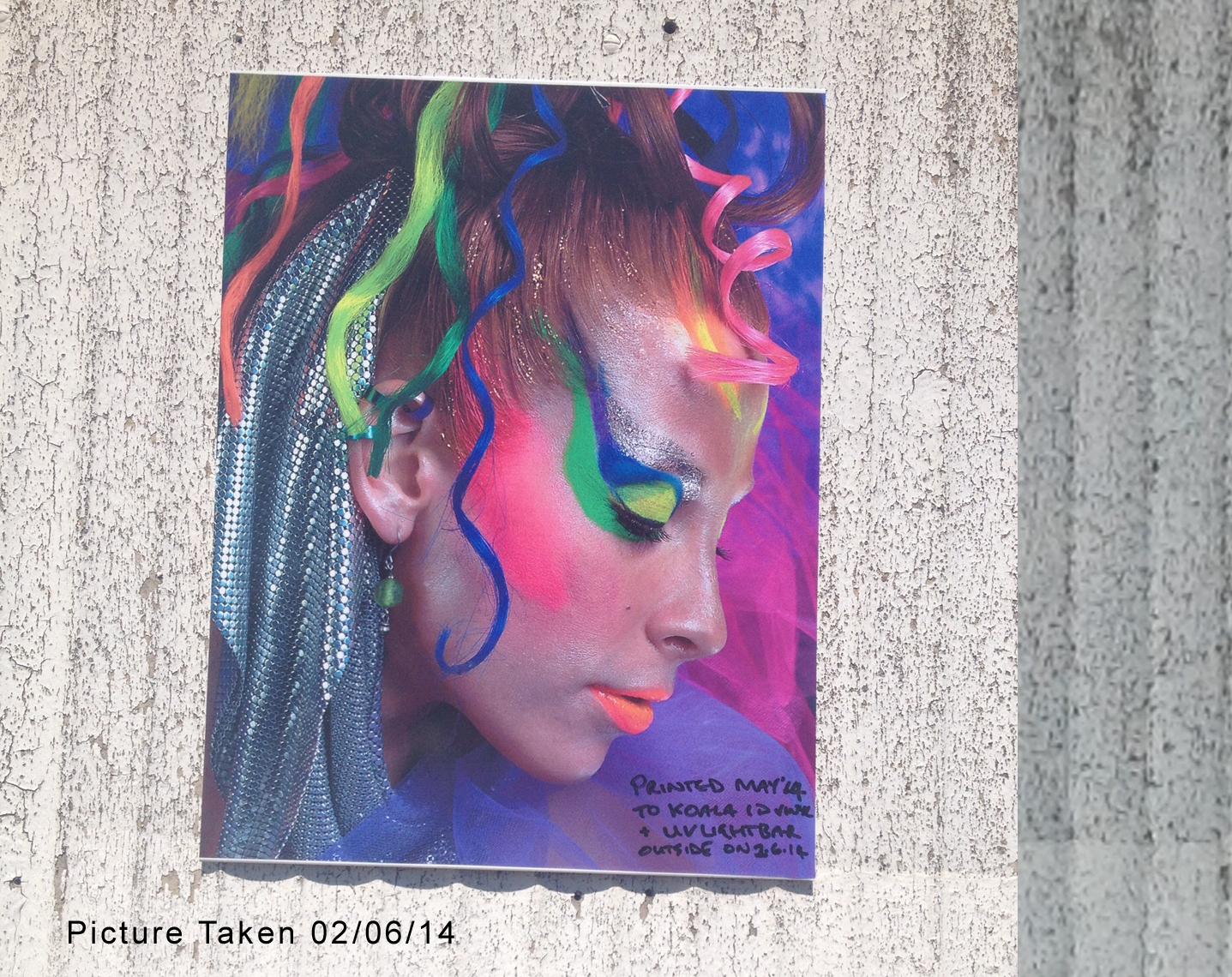

    Rob, you could also add in less lamination time and costs, both to the customer and us, certainly I am ‘probably’ only going to laminate prints when they are going to be placed in bright full-on sun, especially in coastal locations, or when going onto vehicles, and I possibly wouldn’t even need to do this, except for peace of mind.
    Tom the techie’s eyes nearly rolled to the back of his head when he asked what vinyl I was using, so he could make a profile, and it told him it was called ‘Koala 1D’!
    By the time he had finished profiling it, he said it was one of the nicest vinyls he had profiled, and thought it far better than Oracal (which I also use).
    I haven’t purchased the Koala vinyl before, (Antalis supply it) but thought I would give it a go. I bought a 1520mm wide roll and had it slit down to 900mm and 620mm, because I simply CANNOT make my arms stretch wide enough to get both sides of 1370wide vinyl! I have a full width roll for when I do need to use wider, hopefully that won’t be too often!
    I got the Koala in bubble-free grey back, and to be honest the backing paper and ridges feel the same as the Oracal one that I use. Because I am using bubble-free, or air-release it is much easier to lay down, otherwise I would have to laminate or use app tape. For me it is worth the little extra expense to have bubble-free as a daily use vinyl. Sorry, rambling now!

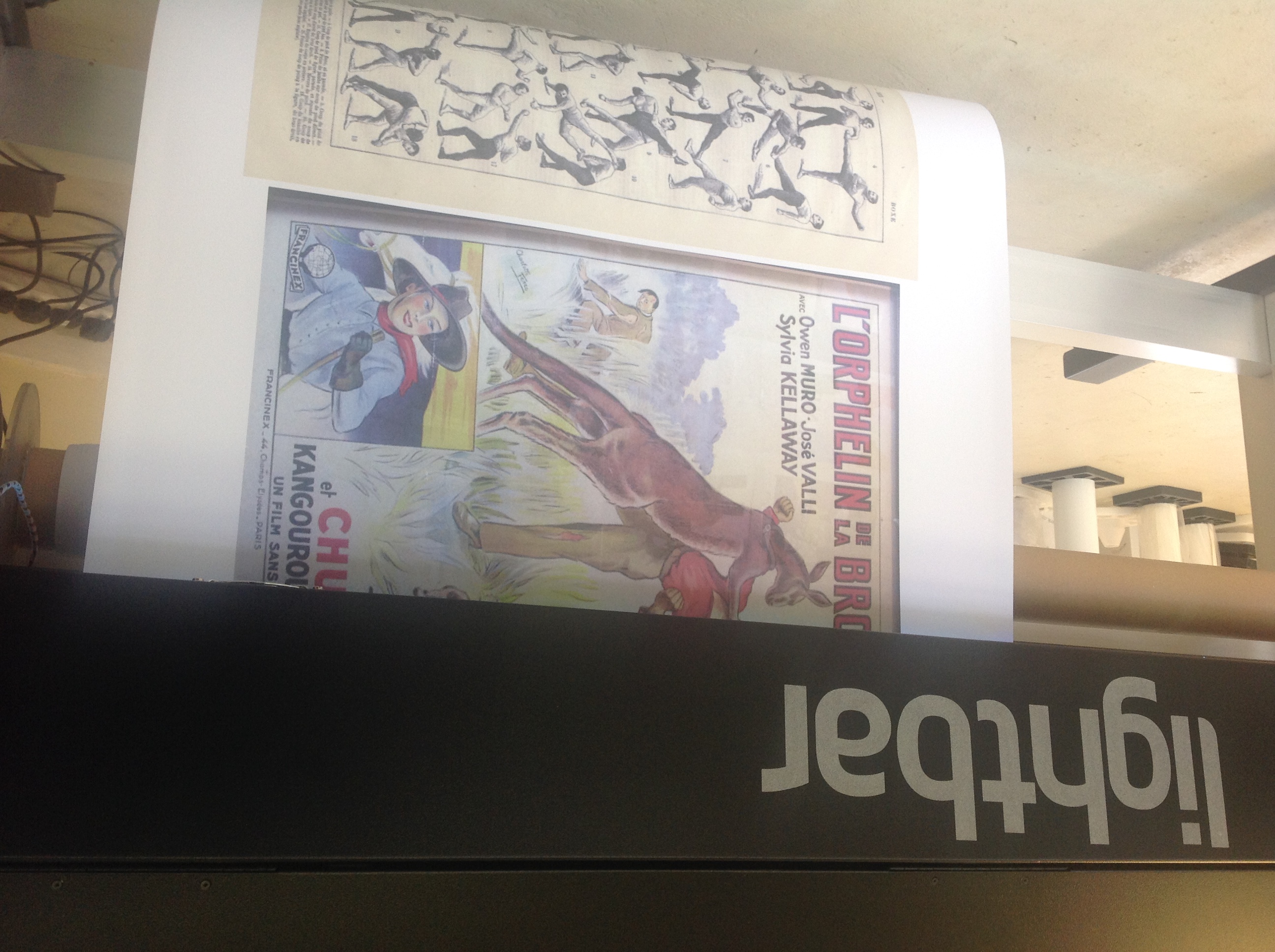

    Hi Boyd
    I am printing to a matt waterproof poster paper, and I can safely say the print is matt-as flat as can be!

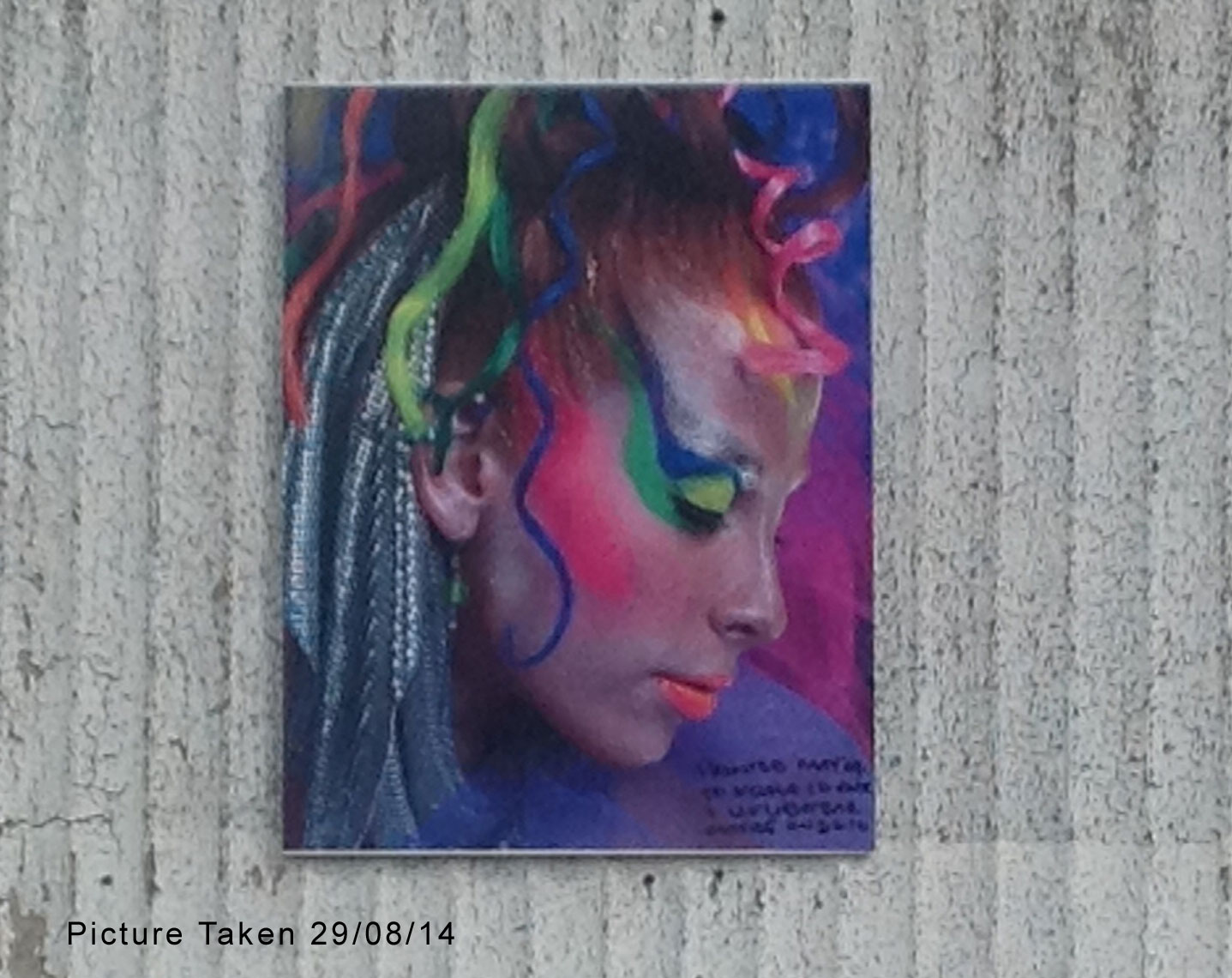

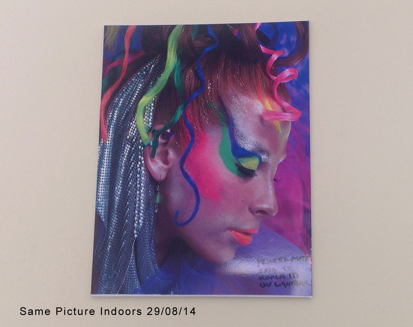

    29 August 2014 at 10:45
    In reply to Emyr, I have done a few garment prints now, after testing for myself. I put my logo and text onto a polo shirt, which has been washed (30 degrees only) and tumble-dried on hot several times, and so far is as good as the day it was printed. I am doing a batch of clothing at the moment, have total confidence in it.
    Regarding the ink cost, it is the same as genuine Roland carts, which I always used anyway, so no problem there, for me.
    I did have some issues to start with, which were down to profiles rather than the ink or machine, now they are sorted out (more profiles made, thanks to Tom Plunkett and Colorific) and the cutting set-up fine-tuned, I am a very happy person, and I LOVE my printer.
    I have so far printed roll-up and normal banners, polyester flags, canvas, garment vinyl, self-cling, clear and white vinyl, gold and silver chrome normal vinyl, reflective print vinyl, and various poster papers. There has not been a hitch on any, and I have not laminated anything so far.
    The image I put outside on a south-facing wall still looks like the copy I have inside, no fading that I can see at all, and was put outside on 2nd June, so almost three months ago.
    Best move I ever made, was buying this old printer, with new technology, and I love that I no longer stuff up prints when laminating, with creases, dust etc.
    Lorraine
  • Lorraine Clinch
    29 August 2014 at 11:03

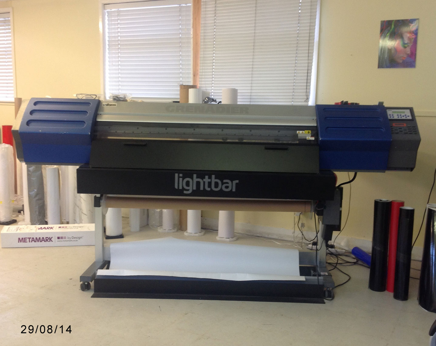

    Hi everyone, as above, images of prints internal and external, almost 3 months on.
    Today’s photo taken when the sun was not shining. No idea why some are upside-down, they are fine when clicked on!

    Well guys was ready to take the plunge placed an order for the lightbar and eventually got samples but we did very quick light nail scrape and got horrific results we will not be proceeding, two pictures same are light bar third picture is our solvent print. Couldn’t use the same photo though
    5 November 2014 at 22:51
    Adrian, Very interesting, i have already did this test several times.
    However, I printed my tests on :
    1, A Solvent Printer
    2, A Latex Printer
    3, A UV Light-bar Printer
    I used the SAME :
    INK & ARTWORK File
    I printed all three at the same time and gave them 36 Hours to dry/cure.
    I got exactly the OPPOSITE results of what you are showing here.
    Your result is your result, but it certainly not a proper comparison result by any mean.
    also, when i did my tests i used a screw driver, allowing the weight of the driver to determine the force i used on the print surface.
    regardless, interesting results… thank you for your input to the thread.
  • Adrian Hewson
    5 November 2014 at 22:56
    Hi Rob we do not have the light bar, we got the samples from colorific that is why I could not use the same file, this was a very quick test that I did just as we got the samples and compared it to a solvent print that was lying on one of the fitting tables which had not been laminated yet, the solvent print was less than 24 hours old. As everyone knows we had a Annapurna M which we scrapped because of this issue and fading in sunlight, in my opinion based on the samples that calorific sent us , prints must be laminated
    Must mention that prior to posting this these photos were sent to colorific and they did not disagree with us ??
    5 November 2014 at 23:13
