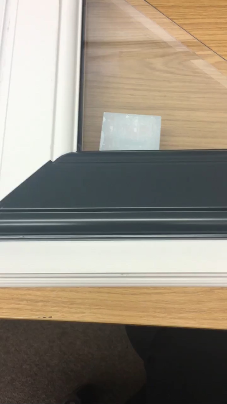

  • Gill Harrison
    November 24, 2017 at 8:01 pm
    Hi Andy
    We stock the Avery Facade and supply part rolls so you can take as little as 1 metre for next day delivery. We also offer a slitting service so you could have 2 or 3 metres then we could slit that into multiple narrow rolls (very handy for window frames).
    The Avery is a single layer cast so very soft and comfortable but the main aim is to install it without stretch. It DOES NOT have any bubble free adhesive but this is a huge positive as it allows you to install it wet or in damp cold conditions.
    We do taster sessions for customers to come and learn more about the product and have a play with it either at the Avery training centre in Milton Keynes or up north at our Head office in Barnard Castle.
    This is a screen shot from some video I have of it installed onto curved window frame profile but it’s installed without heat. The fact that it is so thin and soft certainly helps
