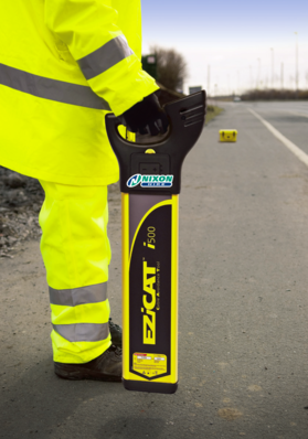

    we bought one about 8-9 years ago now, best thing we did Warren, I wouldn’t dig a hole now without one! it is amazing the amount of underground works you would never dream being there, is!
    like you, we have had a couple of close calls… one is all it takes!
    we paid about £500 for our ground cat scan back then, i imagine they may have come down in price a bit by now. we did contract work for a hire company all over the uk, so always were given one to use on site for free. soon as that work stopped, we bought our own.
    make sure they go through the ins and outs of using it though. doesnt take long but worth knowing what your doing as it can be confusing and there is a proper method of use.
    http://www.nixonhire.co.uk/cable-detectors-d51520.html
