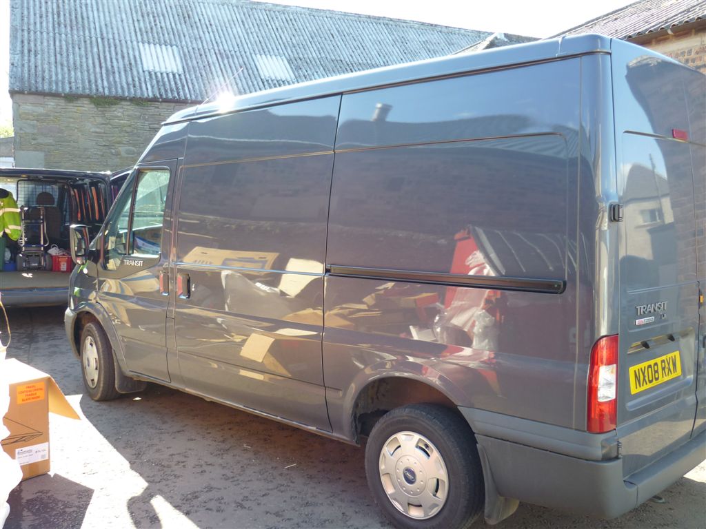

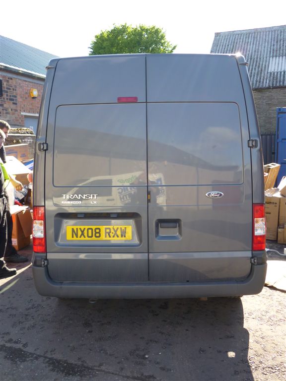

    I’ve just been sent photos of the vehicle from the potential customer – and to be honest – from the images doing a colour wrap in either a high quality cast or a self-coloured wrap looks well within my capabilities as there really isn’t any areas that overly concern me – it being almost flat with no sections that scream ‘wrapping nightmare’. Then doing a livery on top…as printing a shockingly vibrant pink (Digital TV) isn’t the Cadet’s forte.
    Also looks like a MWB…but that’s no big deal.
    Also – is it ‘usual’ to do the top of the roof…having never really looked on top on many wrapped vans before…
    Now, I’ve not done a full vehicle wrap, but have done large wide panels in and out of (nasty deep & textured) sprinter recesses, wheel arches, bonnets etc. so I’m not really intimidated. And like Rob says – I’ll stand by it 100% once it’s done.
    Thanks for the price advice…and time estimation. I’d though 10-12 hours so not far off.
