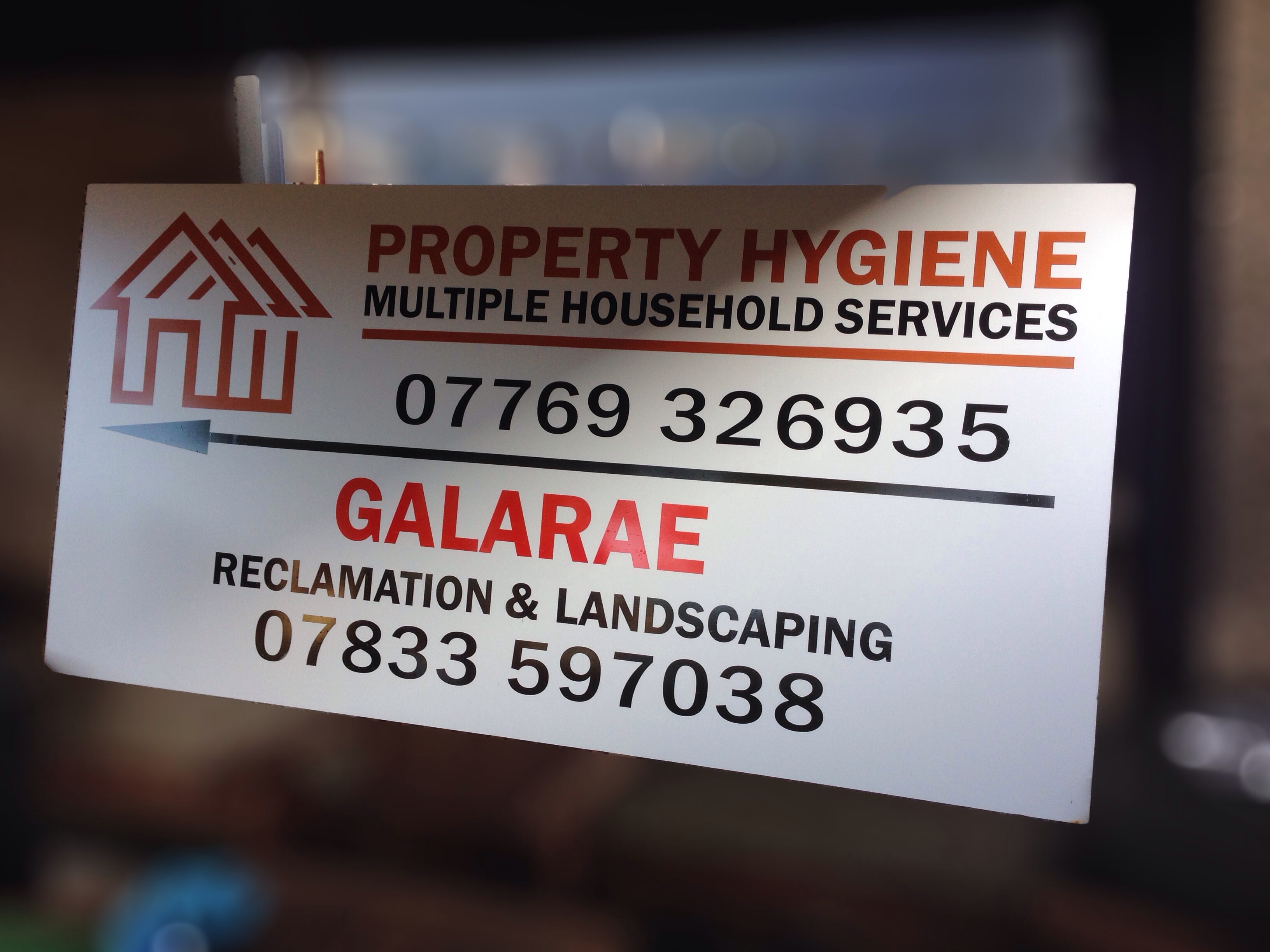

    I will attach a pic of the signs, not that you can see the bubbles from the pic (hopefully), but it will show the kind of text etc….

    guessing this is onto composite board Robert?
    have you changed your brand of vinyl or application tape?
    personally, going by pictures only. i would say its squeegee technique.
    tell tale sign there is the crease on one of your letters.
    if you have changed media, something simple like the media having a higher tack than your used too will do it.
    room temp as has been said, humidity too… all promote adhesion particularly onto the likes of a painted surface of super smooth face like acrylic and composites.
    basically, your laying your graphic flat down and by time you get to squeegee it down its already starting to tack.
    you need to levitate the letters and squeegee towards them laying them as you pass over. hence why im saying its squeegee technique because if you get this correct it wouldn’t matter what media your applying it should still work regardless.
    best of luck mate…

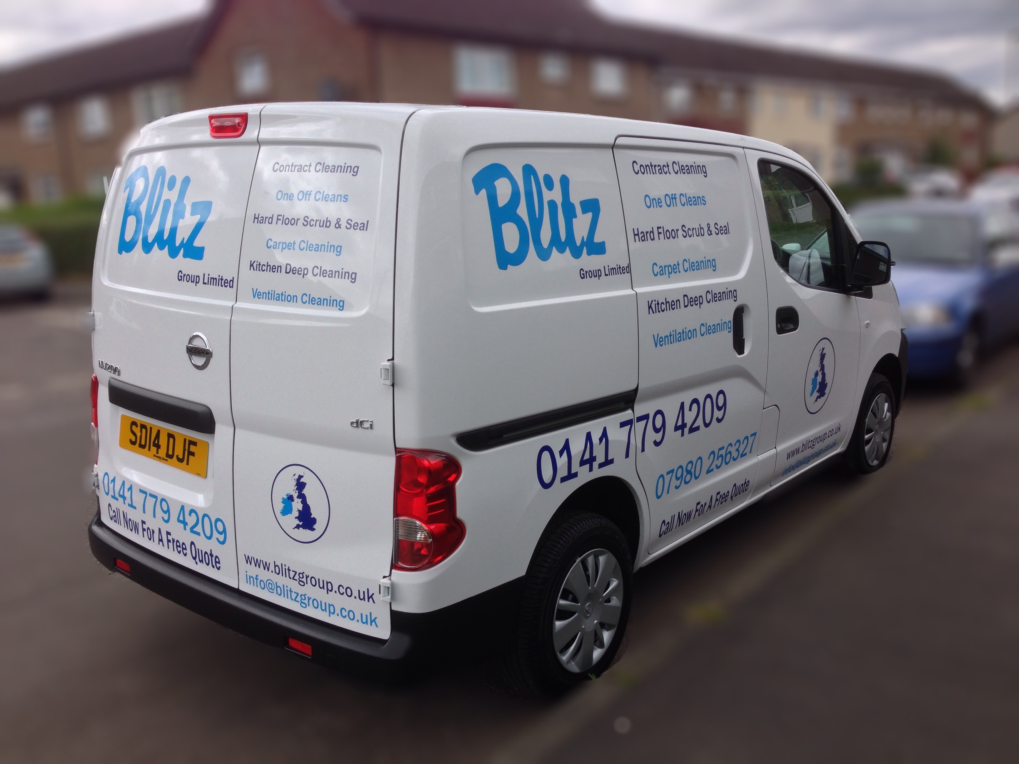

    The last van I just did (pic attached), I used a new material to me anyway DeTape, It felt really nice and soft to use, especially when weeding. But again lots of bubbles. I did contemplate whether it may have been my application papers tackiness, so I even tried soaking it to remove it, which did make it remove easier but never helped regarding the bubbles.

    Infact people…. see if you zoom into my white property hygiene sign that I have done you will see the bubbling and how bad it is.

    Did you manage to zoom into the board and see the bubbling ??
    2 July 2014 at 01:23
    I hadn’t done but have now, afraid that wouldn’t have gone out the door to my unit no matter how high up it was going.
    Does look to be something like squeegee action as Robert has said already, think he is talking about the second "A" in Galarae when he mentions a crease.

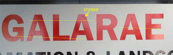

    Robert, if you look at the cropped sections of your sign ive attached below.
    Look at the smaller black text.
    the bubbles are only appearing around the perimeter of the smaller letters.
    this indicates squeegee technique or a combination of loose/slack application taping or high grab vinyl. such as a cast.
    if the application method was correct neither should matter.
    but loose applied application tape can cause issues like this because your going from no surface tension where the tape is to surface tension where you squeegee rides up over the letters. preventing proper expulsion of air below.
    a bit like… have you have double tapes a word with two bits of application tape? when you remove the tape your letters are applied good, but there is a line of tiny micro bubbles along the line of the double layer of tape. same thing applies, bumping over the double layer trapping air.
    also…
    look at the red letters….
    you can see ive indicated the crease which will be a result of squeegeeing angle or the vinyl that has already tacked down.
    also, another thing that indicates squeegee motion, angle is look at the yellow lines ive drawn. you can clearly see definite lines of bubbles indicating your squeegeeing is not correct. as your missing swipes or similar.
    of course this is just guess work based on pictures you have provided. 😀

    As for the crease on the A. It’s def not a crease, must be a reflection from something. I have attached another pic that i have of it. Coming from an angle. Nothing on the A. I would take any creasing out if they occurred.
