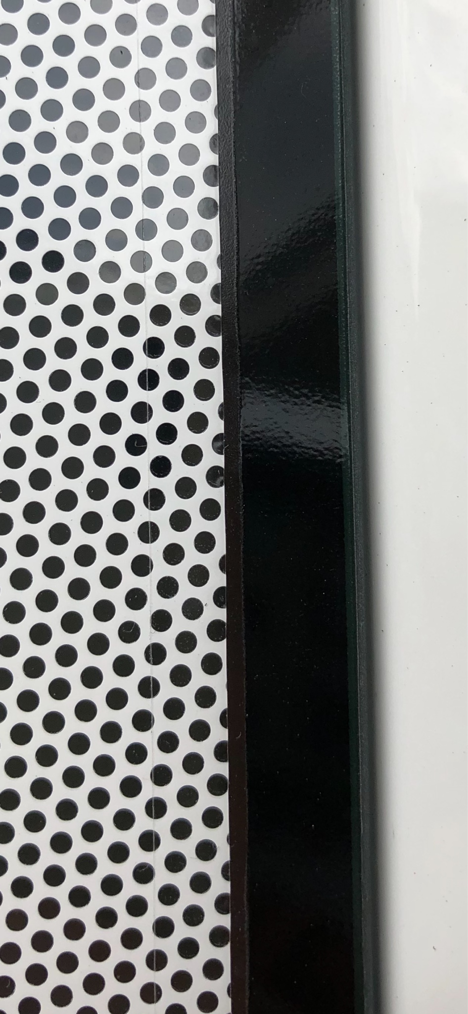

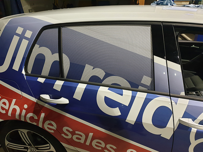

    This is the first time i’ve used contra vison. As per the attached photo is it best to keep the complete window covered or trim the excess off as only part of the design is covering the glass.
    any tips for increasing the life span would also be appreciated too.

    Hi Martin, I would leave it as it is, it’s far more likely to get snagged if it’s trimmed to the design, it’s safer left out at the edge of the glass. Is it laminated?
  • Martin Gray
    June 21, 2019 at 5:43 am
    Yes it is laminated Kevin.
  • Kevin Mahoney
    June 21, 2019 at 5:49 am
    Then I would say you’ve done as much as possible, nice job
  • Pane Talev
    June 21, 2019 at 7:42 am
    I always trim contra-vision 5mm from the edge of glass and seal with 10mm clear long lasting vinyl

    Hi Martin, your job looks spot on. Great work.
    Great idea
