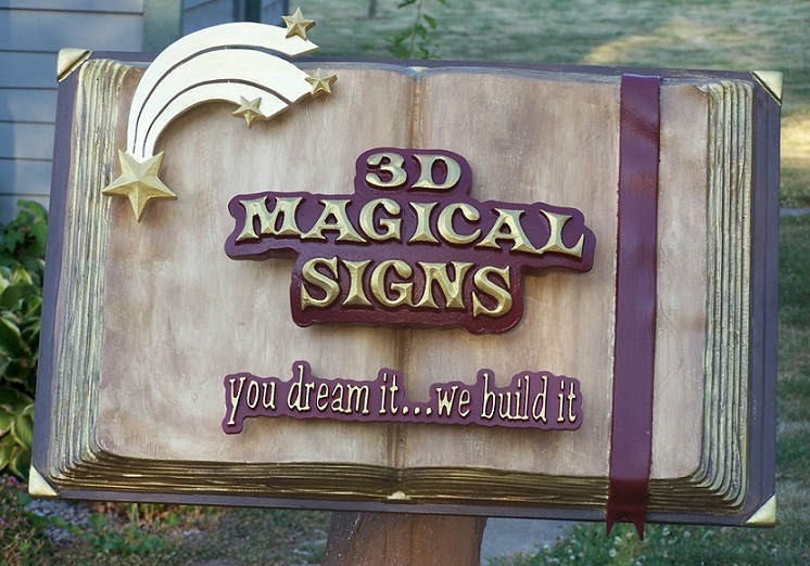

    I wanted a sign that no one else has. I welded the armature, covered it with screen, concrete,paint.
    book is hdu, 4 inches thick.
    thanks for looking.
    rob

    in the center of the tree I used 3 inch square tubing. I set a 4×4 in the ground. they are actually 3.5×3.5. I trimmed the post to 3 inches above the ground and set the tree down over the post. the post sticks up about 18" in the tubing – holding the tree in place. and the tree is heavy, so I don’t think its going anywhere.

    we now do the concrete differently. we use one coat. 2 parts fine sand and one part Portland cement. add a pinch of 1/4" long poly fibers to the water, stir, then add sand and cement. trowel on – this takes a little practice, allow to set and carve when the cement is just right. this is the dan sawatzky method.
