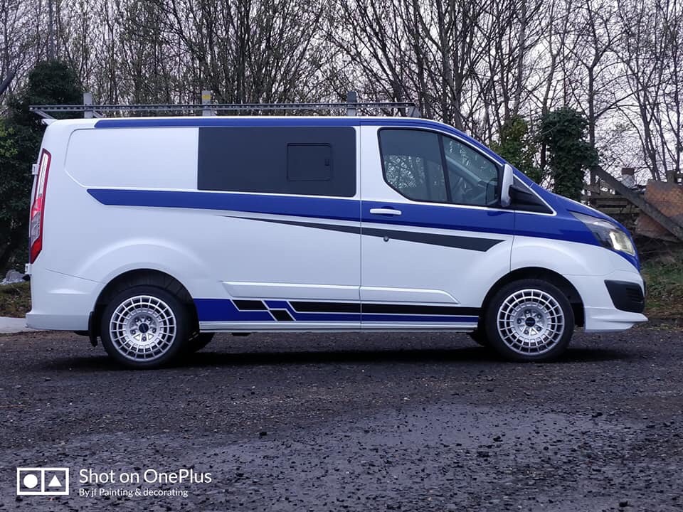

    Very nice, Which tape did you use. I have tried several.

    Here’s one I did earlier this year. I think knifeless tape is the only way you can do these, as the vinyl nedds to wrap around the headlights involving stretching the vinyl around all the compound curves. A flat cut vinyl shape simply wouldn’t fit without massive distortion

    We use the 3m knifeless Tape. Have used others but non compare.

    l mainly use 3M knifeless but on longer straighter cuts l also use Wrapcut and Wrapcut pro, as the filament is on the edge of the tape if you apply the in the right direction there is no lift of vinyl when it is removed and its a lot cheaper if you are on a tight budget
