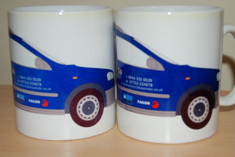

    I have been printing my first larger batch of mugs today so did a test using the cheap Chinese paper that I have and Xpress sublimation paper. Both were printed at the same temp/time/pressure
    Here is the result…….the Chinese paper released the ink far better….deeper more solid colours that are more defined……even taking cost out of the equation I pressed the batch with the Chinese paper.

    That looks like you used the wrong side of the xpres paper, that mottled effect on the mug on the left is what happens when you do that, I use the xpres paper and have crystal clear sharp images every time.
    obviously maybe this isnt the case but ive done it and thats the result.

    First thing I checked Steve……..maybe it simply is not good on the cheap mugs?

    What time & temp are you going for John? Both mugs look a tad yellow at the top.

    I know this is not the problem as you used the same specs for both but I was getting that same mottled effect and found it was down to pressure as I had it to high, I took off pressure and it sorted the problem.
    looked exactly like that though 😕

    Yellow walls in the room 😀 think it is a reflection.

    I use the XPres stuff and ive had a few problems lately which has proved to be simply down to the temperature change. After some advice on here ive been pre warming the mugs for 10 seconds before pressing and its much better. Ive also increased my pressing times to 5 minutes from Xpres’ recommended 4.5 mins.
    As for the yellowing at the top, I always try to make sure the paper covers the full mug to avoid the yellowing (which I assume is simply burning), it looks like perhaps your transfer didnt cover the full cup?

    I use the xpres paper on the mugs, at 190 degrees for 220 seconds, this allows for the cooling down of the press when you put the mug in first, get a perfect result every time, very sharp and crisp, ofcourse could be a dodgy pack of paper I had some paper once that was useless but was from another supplier, worked fine on the shirts but no good on ceramics or wood products

    Just a thought, you can get sublimation paper for hard and soft surfaces, cant remember if xpres do both but that’ll be your answer, the soft substrate paper will give a mottled effect as it has a different texture sometimes.
