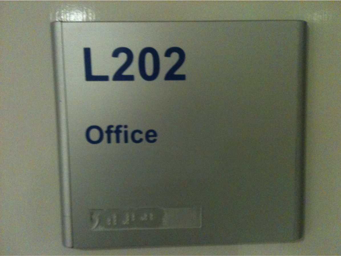

    Tried that route but looking for this particular method of Braille manufacture
    which seems to be moulded and stuck to the aluminium extrusion.

    Hard to tell exactly, but this might just be thin Phenolic / Novacryl applied to the face. I’d opt for "Raster Braille" (do a Google search) though if you don’t want to do a full photopolymer. I think the small applied bands on the sign face don’t look as nice, although they are cheaper to make. Hope this helps some.
