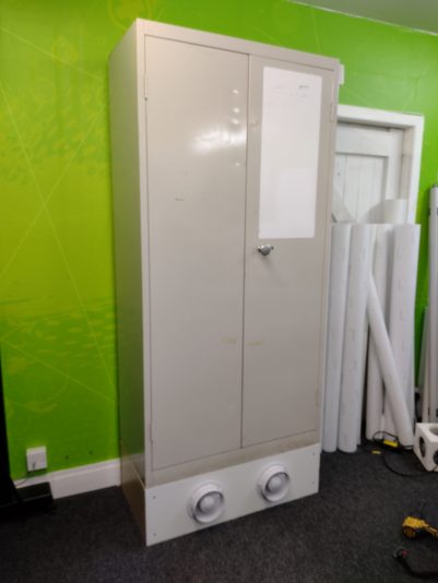

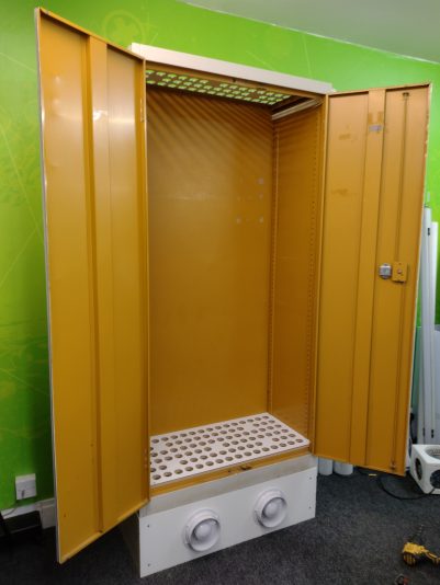

    • David Stevenson
      28 January 2022 at 21:15
      Hi Kevin, we’ve always left it loosely coiled sitting on a rack raised from the floor with mesh on the bottom. This problem has definitely only started since the TR2 inks appeared. We’ve just started to attempt to make our own profiles for Onyx which is a definite learning curve. Seems there’s no Onyx profiles available for the VF2-640 🙁

    • David Stevenson
      3 November 2022 at 10:16
      @DavidHammond In all honesty the drying cabinet hasn’t seemed to have made a great difference. I’ve had material in for a week that’s still super tacky when been applied.

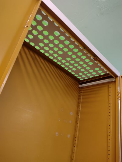

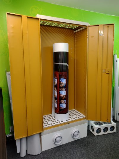

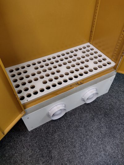

    2 November 2022 at 00:06
    @David-Stevenson that’s a really good attempt at creating a drying unit, well done mate.
    I have had various full solvent and eco-solvent Roland machines over a 12-15 year period and they are bulletproof with regard to ink performance over the likes of latex when it comes to “wrapping”. but like all inks, there is strict outgassing prior to the lamination processes required. Clearly, you know this, David. Hence, building your drying unit. 👍
    Solvent is heavier than air, so it naturally falls with gravity, so I’ve always been of the opinion that a fan at the top blowing down as well as the bottom, if not only the top, would work best. However, I think the fan blowing down on a coiled roll may blow it over.
    In the past, and due to doing high numbers of truck wraps, we would elevate the prints and let them hang dry. the reason was that rolled-up vinyl does not give a clear 360-degree space to air. it bunches and touches in areas, preventing 100% material outgassing. in some cases trapping falling solvent between lower bunched areas.
    I say this through my own errors. By that I mean, I would print a truck wrap and coil the prints on their side and let them dry. then I would go and fit the prints. Up to twenty-six, 94inch x 52inch vinyl panels per truck.
    I noticed that one side of the prints was often tackier than the opposite down the length of the drop. so as a test, I would mark what side stood on its end, then keep note when it came to fitting them. and the tacky side was always the side nearest the ground!
    Hanging by its side is better than hanging by its length because of the distance the solvent has to fall to clear the bottom of the sheet.
    Obviously, all of what I have said above does not answer your question/problem. But thought I would add these comments because it is a good relevant topic being discussed by real users and a great example of a drying unit.
    I think Roland stating prints can be laminated within 6 hours is stupid and I have no doubt at most this has been decided by laboratory testing rather than real-world testing. No disrespect to them, but big companies like this deserve to get their fingers burnt with this type of statement because it is wishful thinking on their part and done to generate sales. So we, the sign makers, printers, wrappers take the hit for their innacuarte claims! I dont single out Roland, even vinyl manufacturers do it all the time with wrapping vinyl claims!
    I realise i am rambling on here, so i will shut up. 🤣
