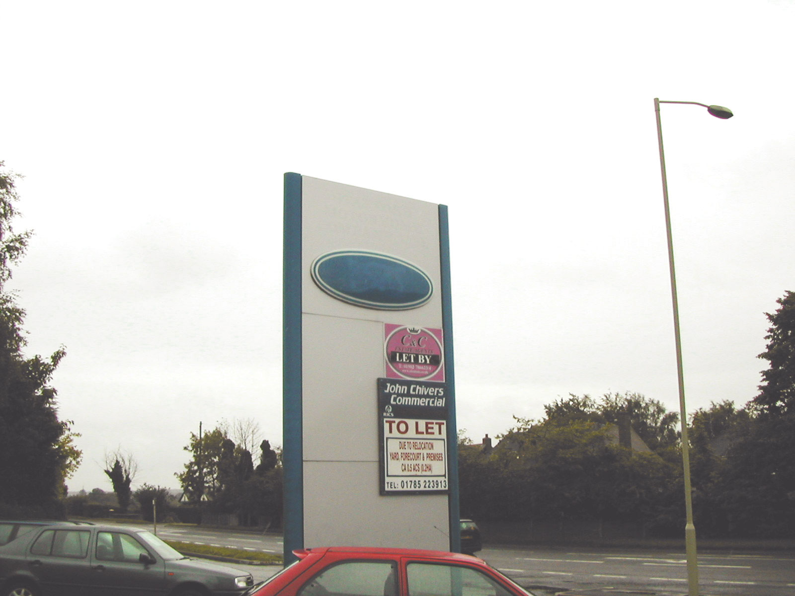

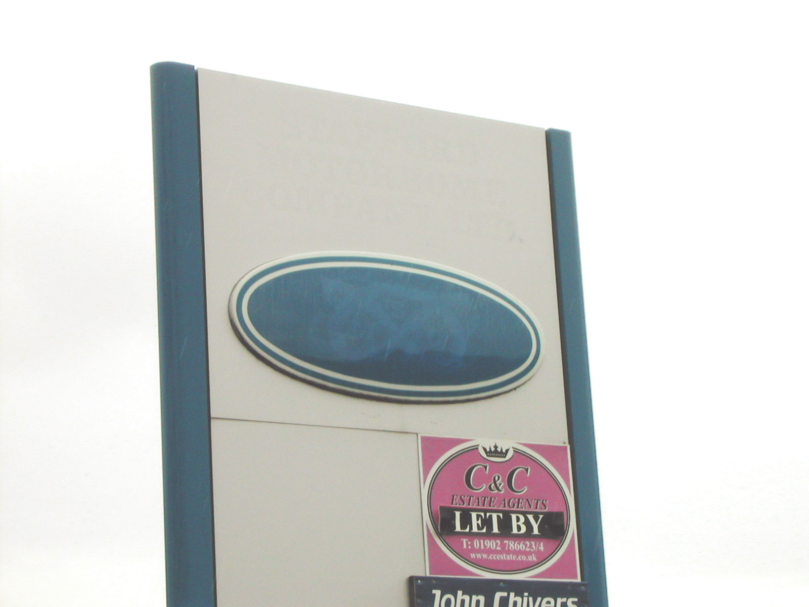

    Hi All, does anyone recognise this totem sign? is it an off the shelf type of product i need to replace the top section
    any leads would be appreciated
    sorry about the cack photos
    G.

    Looks like the Mono-frame from Spandex, sold through their Sign Centres – you should be able to replace the panel with powder coated Aluminium and secure in place with VHB tape.
    Regards Craig B
  • Craig Brown
    September 7, 2006 at 1:27 pm
    Should have added you can down load the P D F for the system here http://www.spandex.co.uk/en/products/si … frame.html
