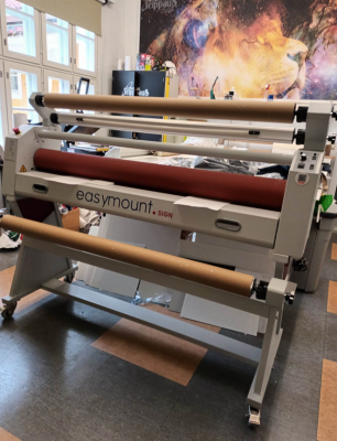

    Hi folks.
    So I finally got my new Easymount and in the coming days when I find some time will try and figure out the best way of setting it up and using it.
    I know many of you have one of these and thought it was worth asking for any tricks/tips and how you use it.
    * Do you use the media tray or the media mandrel?
    I put the media mandrel on the front instead of the back as I think it makes more sense for my setup.
    TIA

    we always use the rear mandrel and have it roll it back up too ..tried all ways with ours but find that method more reliable

      Thanks Allister, the only real issue i seem to have atm is buckling/bowing in the middle of the media as its feeding through. According to the troubleshooting guide its maybe caused by too much pressure but im lowering the handle until they touch and thats about it. Also do you use the hot roller?
