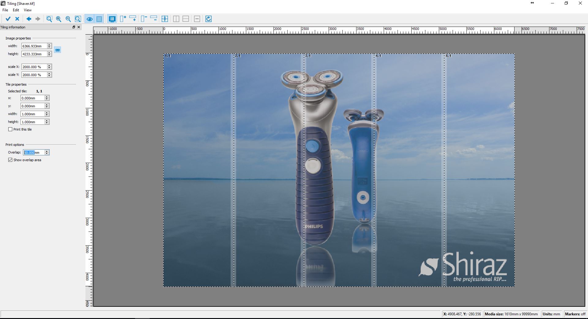

    One thing to look out for with tiling is to ALWAYS use and overlap and crop marks from the RIP (not crop marks in an image). Particularly if you’re scaling an image up by massive amounts. If your artwork is 1mm out and you’re scaling to 2000% you’ll end up 20mm by the time you’re printing. I always try and use a RIP for tiling rather than a design package as that’s what they’re written for after all.
    I hope that’s of use? I’ve attached an image of Shiraz tiling to show you what I mean.
