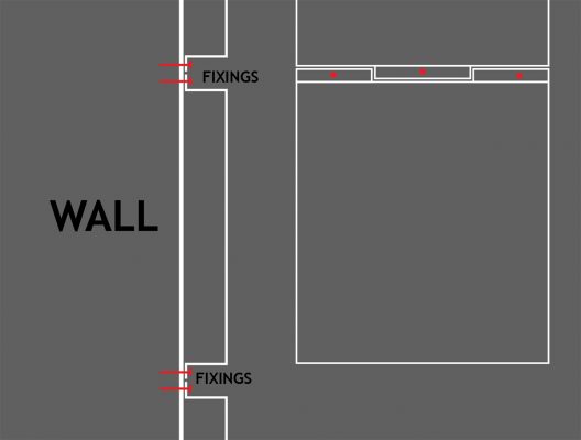

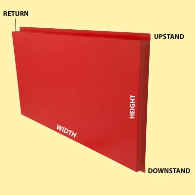

    Sounds like you need an upstand, or “top hat” return.
    Hard to explain, and I’ve not got my laptop to draw a diagram.
  • Michal Uhruski
    February 27, 2024 at 8:45 am
    Thanks! Like so? Fold the return again the other way to create a lip?
    Michal
  • Michal Uhruski
    February 27, 2024 at 8:48 am
    Yeah – makes sense – i thought that i could also cut them out and stagger them from tray to tray so they interlock and i could bring them closer again.
    Thanks guys 🙂
