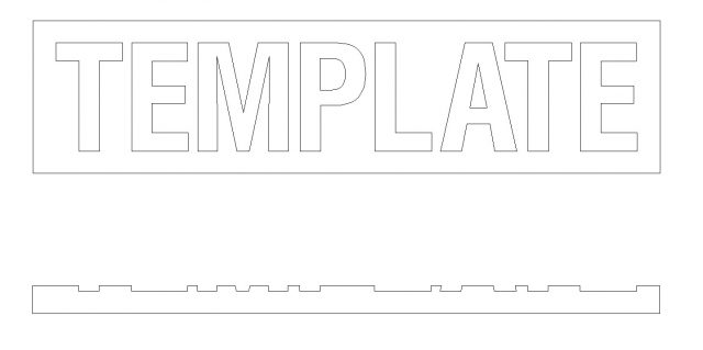

    26 January 2022 at 13:25
    Use the plotter pen on the rear of the vinyl lamination carrying paper. i.e. the paper you bin. (recycle πŸ˜€)
    It is thicker than general paper and the silicon coating helps with moisture etc when working outside.
    The full paper template is great for templates where you use screws etc.
    For acrylic letters where you would glue or tape the letter in place, we baseline cut in stencil low tack vinyl or again in paper which is perf-cut.
    * Top – Template in paper.
    * Bottom – Baseline template in low tack vinyl or paper.

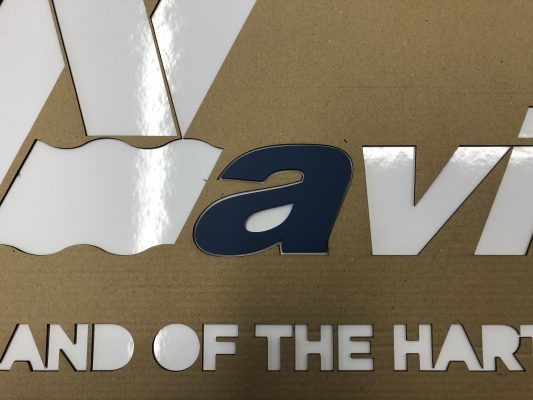

  • Pane Talev
    27 January 2022 at 15:07
    This is my template folks. Stays nice and flat. I have 4 lines of flat cuts. That is why I want 1 big piece of cardboard. I have done it Robert’s way in the past, but this is better for me for this job

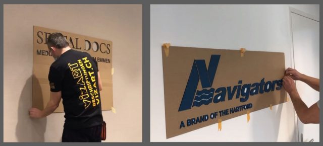

  • Pane Talev
    1 February 2022 at 14:52
    Wall on the left is structural wall paper. No vinyl other than high tack will apply on it. On the photo on the right, removable vinyl can be used, but I still prefer laser cut cardboard. (now that I have laser in-house)
