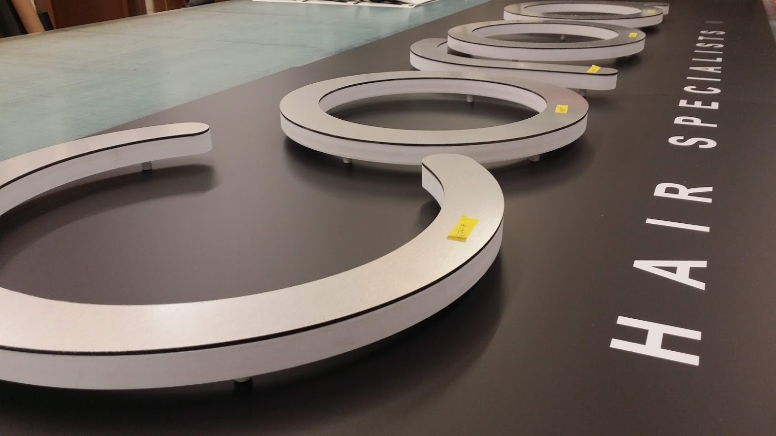

    this is a sign we did 3 weeks ago for hairdressers.
    19mm foamex with brushed 3mm aluminium composite 22mm thick on stand off locators
    flat cut on our cnc router, quick and easy.

    Have done similar Rob but not exactly what we need, after that built up metal letter look same colour face and return but without the massive cost
