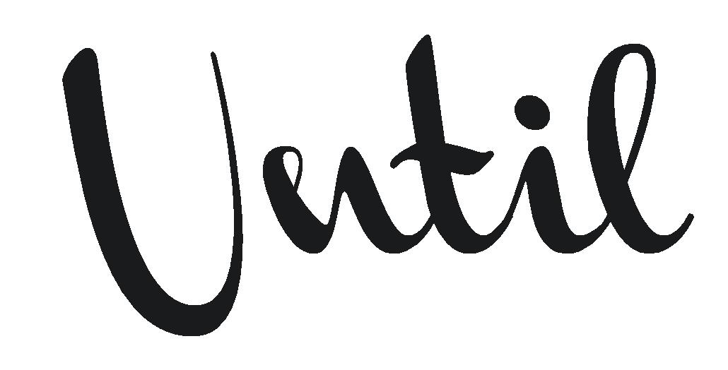

    I have installed a font which I wish to cut.
    When creating the text in Corel it shows as black and exactly how I want it to look (first pic).

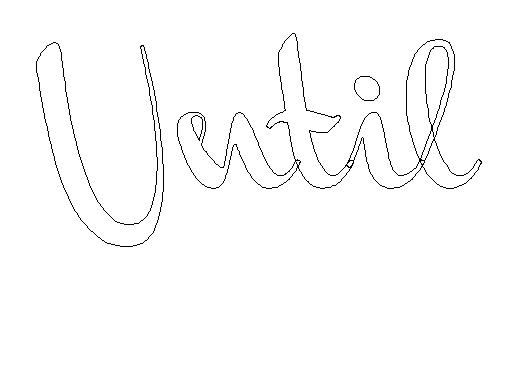

    When I go to cut it, it takes the individual characters and wants to cut each one which overlaps and obviously won’t be good when weeding as I will have tiny bits missing.

    Tried the suggested method. It wouldn’t allow me to select Weld. I converted to curves, then it would allow me to click Weld. It appears to come out as one from looking at the nodes, but on some parts of it the nodes go all over the place and chunks are missing in areas. Not sure why it is doing that 🙁

    there is some sort of limit within corel so braking them down a bit may help.
    also the (l) in the Until will struggle because of the extra lines in the down stroke which should not be there.

    It seems to be the "L / M / Y" that’s affected, the rest weld up OK.
    If there’s not much text just shorten the flick or tail by deleting some nodes on these letters.
