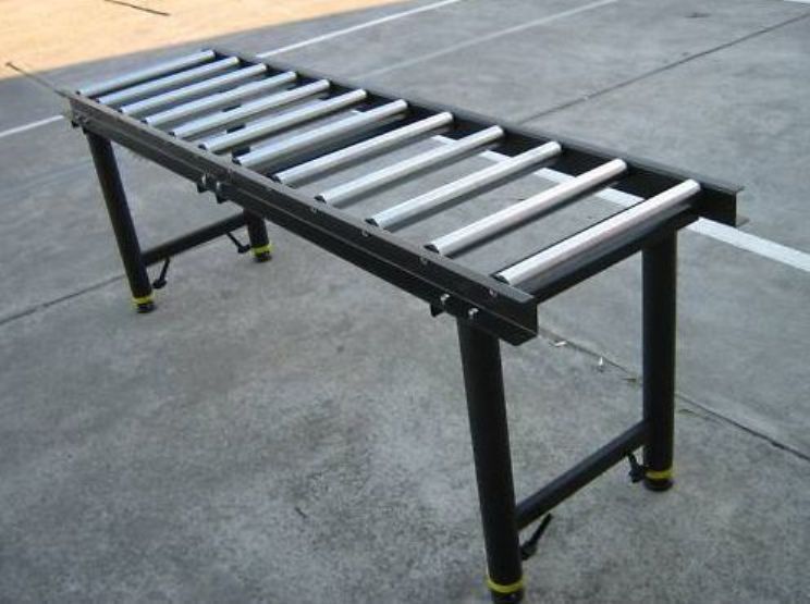

    Also if you’re expecting to be cutting long lengths, a roller table/fence is handy You can get some saws with these fixed to the fence – slides across with the fence. Very handy. Blade should be 80+ teeth with negative rake.
