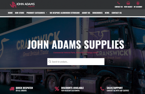

    Hi David
    Try John Adams Sign Supplies.
    They sent us Aluminium signposts “by mistake” when we ordered steel, and we had to return them.
    That was a couple of years ago, but they definitely did them, then. John Adams Sign Supplies

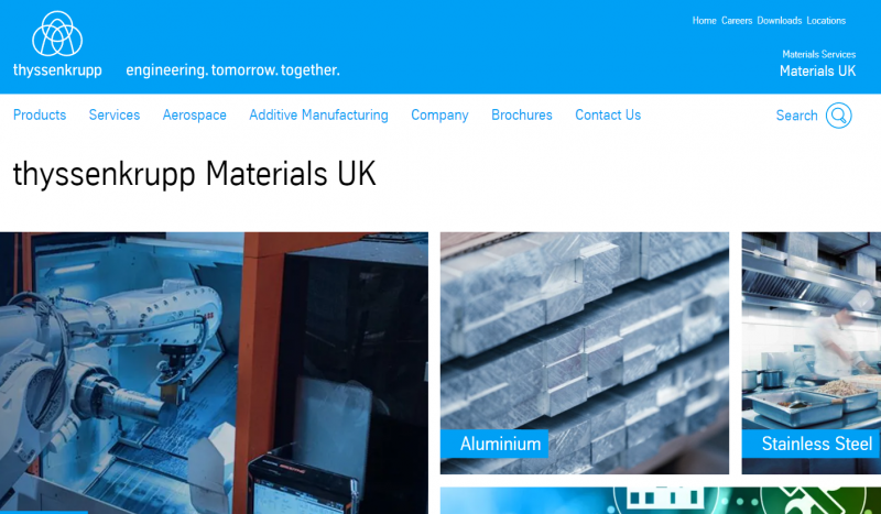

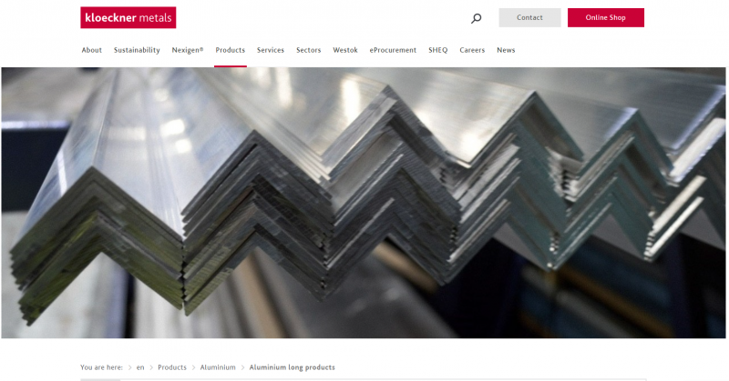

    Hi Dave,
    If it’s just round, hollow tube you could try some of these suppliers…
    ( If it is a specific sign system you will need to put a photo of the extrusion on for help identifying it. )
    * Thyssenkrupp materials
    * RAA Aluminium Extrusions
    * Kloeckner Metals UK
    Although you would need to check with your local branch for stock as sometimes they need to bring them in from overseas branches.
    Hope that helps.

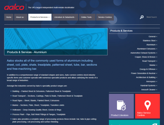

    @andy-thorne
    I forgot about Richard Austin Alloys. I have one local to me and have used them exclusively, many years ago…
    Another is Aalco.
