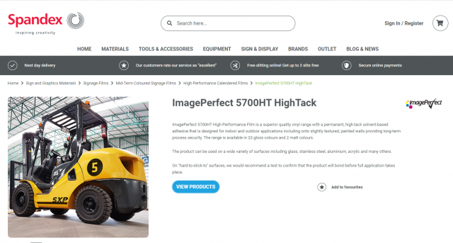

    Quick reply for now:
    Spandex has recently launched a “high tack” Iamge Perfect coloured range.
    Might be worth asking them to send you a colour card and A4 sample to try on the surface.
    https://www.spandex.com

      Thanks but that was what I was going with but I think they’ve stopped doing it when I called up the other day.

    Have used the Hi-tak from Spandex for several jobs and its great, should do the job. Only available in some colours though, like the air release.

    Thanks guys. they have discontinued the colour I needed but there was a few metres left which I’ve now taken so I can get the job done.

    I managed to get some from Spandex in the end but it had to get sent from abroad.
    The bad news is that didn’t stick to the cladding all that well, it’s seems to have some anti stick stuff on it.
