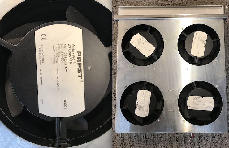

    The cabinet is planed to be angle with dibond sides will either seal or use VHB tape to make air tight if warranted. I have four huge computer server fans mounted in an aluminium panel that I plan to repurpose at the bottom of the cabinet to suck out the air.
    The fans are 48v dc 880ma units. These are modern type fans that have 4 wires + /- then a speed control and a tacho. I decided not to bother with the speed element and so disregarding the speed control and tacho the fan will auto run at max rpm. If i notice it hovering then linking the speed control to the earth will change the fans to run at low speed. (Any techies with knowledge on power please feel free to correct me if wrong and transformer info/ advice would be great as needed).
    So based on my plan the Ecosolvent ink will print onto media of choice collected on the take-up whilst two 12" fans blow air over it to aid drying. Then into the cabinet with the fans sucking the air from the bottom (as solvent gathers at the bottom not the top – Thanks to UK Signboards member pointing out). I can’t work out airflow until the fans get power but I am hoping this will increase Gassing Off tremendously and no contaminants.

    Hi Neil, running 54” Roland Versacamm SP540i so I will have variables over other models / makes. The fan will suck out air and I plan to have an air filter at the top as I do have a dog at work to so hair could be sucked in! I have had issues with laminate failing in the past and so redoing a job and the cost especially vehicle wrapping means I am a lot more interested in hedging my bets! This seems to back up my thoughts that this is a bit of what works for one doesn’t always work for everyone. As mentioned I would like spittle more control over getting the desired results and save some time too. Thank you for your thoughts all the same.
