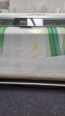

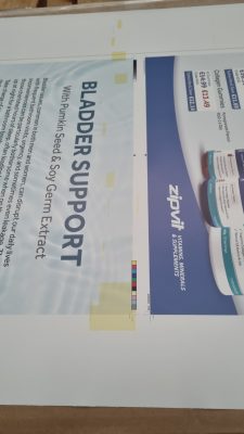

Posted by George Elsmore on 2 September 2024 at 06:12Hi All, long time no see can anyone point me in the right direction with this problem on my sp540i its printing random yellow blocks as in photo please

Hi George
I would first guess at cleaning the encoder strip.
Simple to do, just follow the manual instructions for cleaning that carefully. Then try printing again.
If the fault improves a bit, try cleaning again.alternatively,
Are you having the same problem printing other files?
If not, try saving the file again and sending a fresh version of it.Also, sounds daft, but the old… Reboot the machine from scratch. Power off, PC off, bring in a fresh file and try printing.
Anything is worth a shot before the dreaded technician call out.
i would also think the encoder strip or change the file to a different job and see if the same happens.

Do you definitely need a New Encoder strip, George?
Could it not just be dirty, a smear or whatever, on the strip?If you do need a new one, I would try Jamie, suggestions.
Hi I have cleaned the encoder strip several times and there is a small scratch on it god knows how so I am going down the road of changing it thanks for all th ehelp
Possibly an electrical issue, which may mean a new head, or one of the boards.
I’m not familiar with the machine, but does look like a communication error – check trailing cables & ribbon cables to head carriage for damage.
