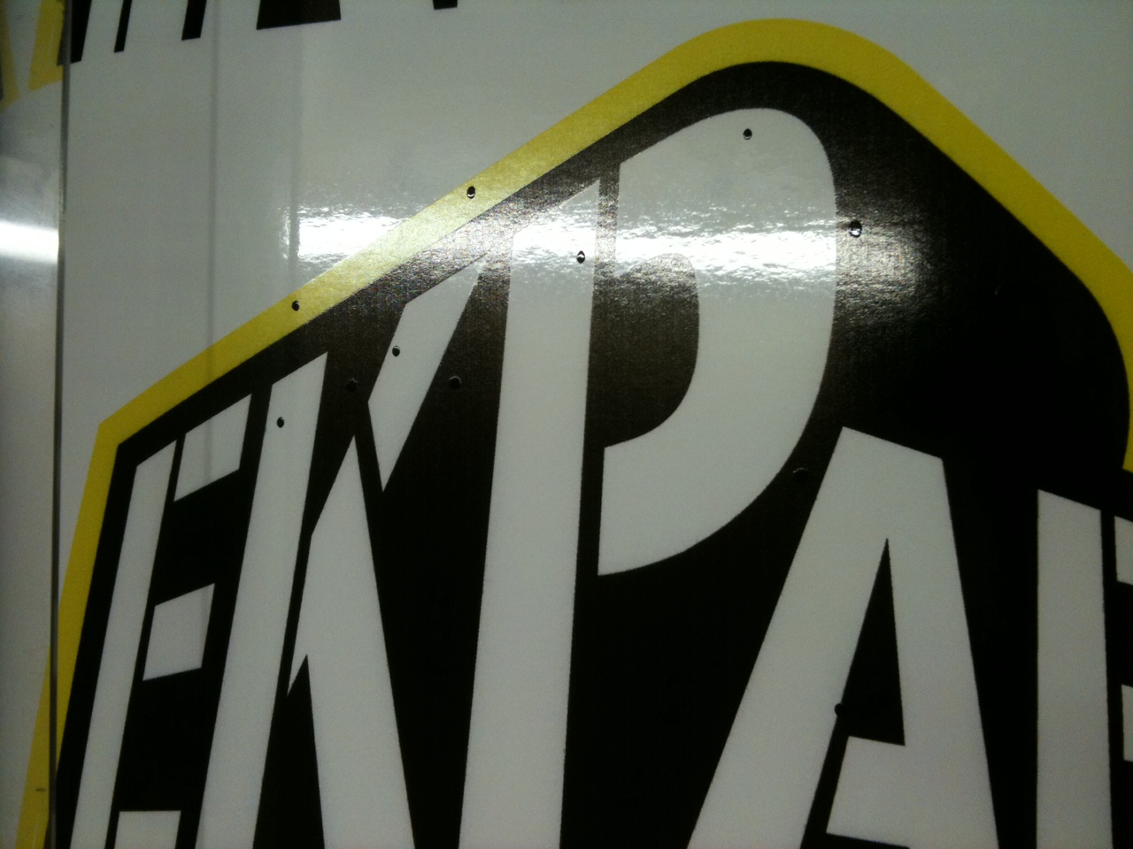

    I printed a job of today, normally i get the odd bit of droplets on the odd job but this morning it was major
    I’ve attached a jpeg
    Anyone any ideas? I’ll get an engineer out asap but is it a major problem or a minor one?

    waste ink full (no room to put ink)
    wiper blade missing, it broke
    any ink in the capping? could be full and not drained away so ends up on bottom of head

    Is the mist sponge ok. I’ve had similar problem before caused by the sponge not absorbing the ink.

    I meant clean the heads with a swab and cleaning fluid……the ink builds up around the edges of each head (each time the wiper cleans the face of the head) and should be cleaned manually weekly at least…..some do it more often some less depending on the amount of use the machine gets.
    I would try this before calling an engineer…..only takes 10 minutes or so.

    You get fluff stuck to the sides of the head. This collects ink, and the next thing you know is this "wick" leaving it’s mark all over the show.
