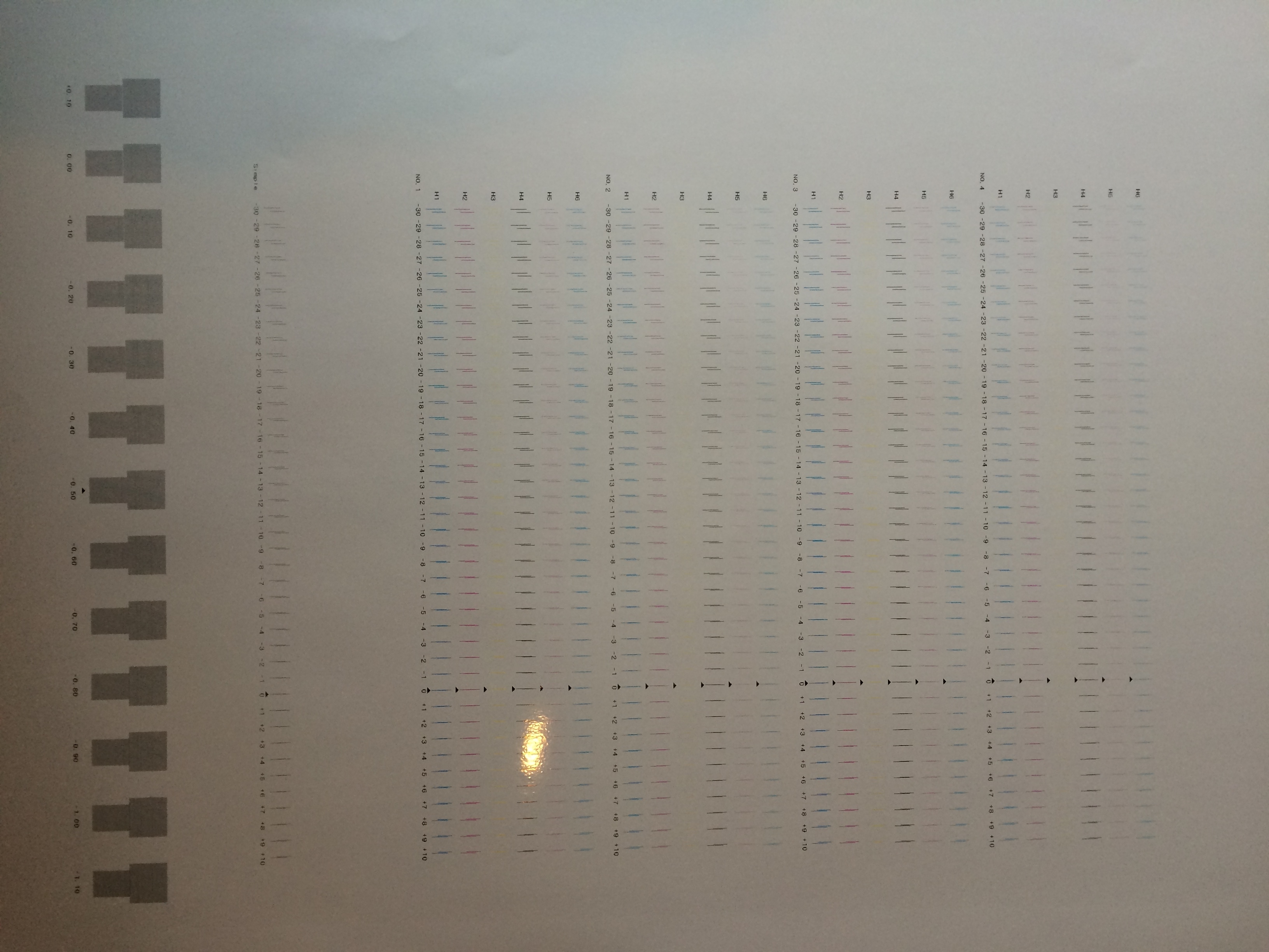

    hi kev I’ve just done a calibration test print and alignment looks ok although look quite bandy, also done another test print of the bi directional i think as now in different office and memory just failed me, yellow looks quite faint is this normal? cheers shawn pics attached,

    sorry can’t see print out on my phone (on holiday in Palma) . Don,t know history of machine but may be slight ink starvation due to dampers needing changing.DOes your machine do auto Environmental check if not its a good idea to do that before printing. Re dampers you can get perfect test print but get banding when printing solid colour due to the amount of ink required. It sounds as if it will be a cyan or light cyan if reds print ok. From the service menu you can print solid bands of colour which will normally give a good indication
