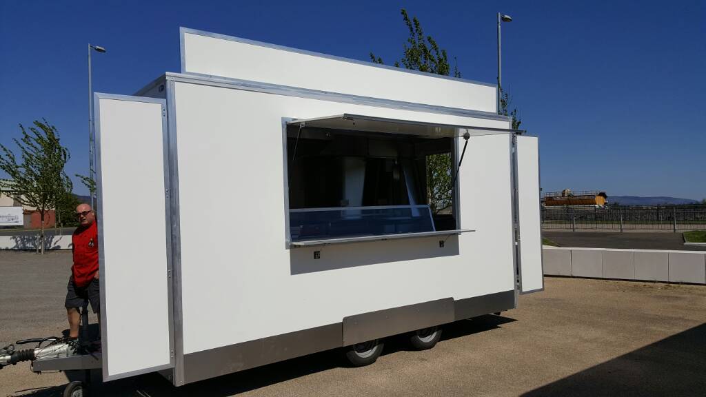

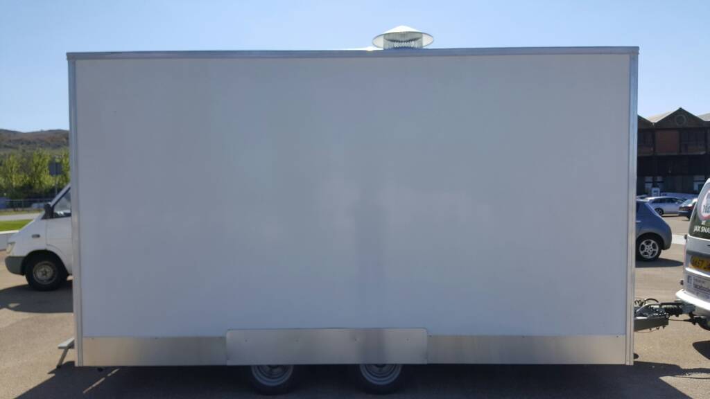

    Got a Snack Van coming in this week for a full wrap.
    Now the backend of it will obviously have joins/over laps in the material.
    Will I be best to put an edge sealer on those joins/over laps?

    Nice to see one in such good nick, last one I had, the client asked if our vinyl would cover two fork lift holes in the back end.
