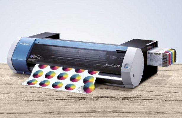

Could anyone recommend a basic printer/cutter with a white ink (for printing on clear) option?
Only has to be 610mm (24”) wide
I looked at a Roland BN20, but was a bit put off by some comments regarding its performanceThis will be used at home (hence smaller size required)
Thank you
Nick

i only now of the small roland machine. well thats unless you can get your hands on an old gerber edge!
I would seriously think long and hard as to whether you really need white ink.
We’ve had 3 different printers over the years with a white ink option, and all it’s done is cost us money.The ink is approximately twice the price of the others.
They advise removing and shaking the cartridge daily to keep it mixed properly.
The opacity of the Roland ink was terrible (possibly improved over the last few years since we owned one).
The print speed was terrible, and if you don’t use it regularly, you’ll find the majority of the ink ends up in the waste tank!We decided with our last printer, which is an Epson, that we should get white ink again (seemed like a good idea at the time).
Once again, we didn’t have enough jobs to be using it constantly, so a very expensive cartridge was wasted by the printer’s auto cleaning to stop the ink from settling in the ink lines.Anything now we need white, we do by printing on clear and backing up with white vinyl. Much better quality, in my opinion and a lot less hassle. As a final note, unless it’s been massively upgraded, I’d stay away from the Roland BN20. Our supplier nicknamed it “the boomerang 20”, as no sooner had they sold one than the customer was looking to trade it in for a better machine.
Awkwardly sized rolls, unbelievably slow print speeds, no dryer, waste ink tank that needs to be replaced when full, the list goes on. Maybe ok for small runs if you are not doing a lot, but should your business get bigger, the BN20 will be out the door faster than you can imagine.PS.
Sorry to sound so negative, but we’ve been bitten too many times to admit it. 🙂 -
Mark and David, thanks for the replies
David, I was already a bit concerned having read a few things regarding white ink. The work I might be doing, would involve only a very small amount of white (on clear) decals. I’ll probably look at something like a Roland VS300 with standard ink set up, And if white decals are ever required, deal with it then. (Outsource perhaps)
Thanks again.

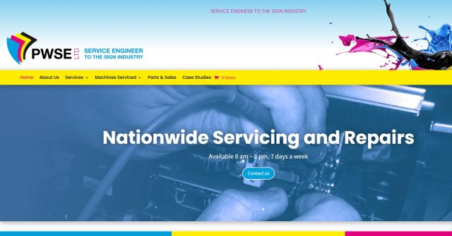

It is possible to get the hardware service and repaired by third parties – oddly enough I had someone in today to look & sort out all of the machines for me (don’t know if I can say the name here but he definitively gets a thumbs up from me – let me know if I can say his name).

What the printer was great for was the likes of small intricate labelling on model railways, trains, and other types of models, where detail was everything. We used to have a few customers who regularly came in for things. then their model club mates and so on…oddly enough I had someone in today to look & sort out all of the machines for me (don’t know if I can say the name here but he definitively gets a thumbs up from me – let me know if I can say his name).
Yes, of course, you can recommend anyone or company you want, mate.
Hi Rob,
Perfect – the person who came to my rescue is Peter Whitehead from https://www.pwse-ltd.co.uk
Very knowledgeable person, sorted the issue with my Edges straightaway, does Summa and Mutoh as well as Gerber machines. -
