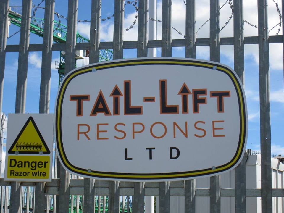

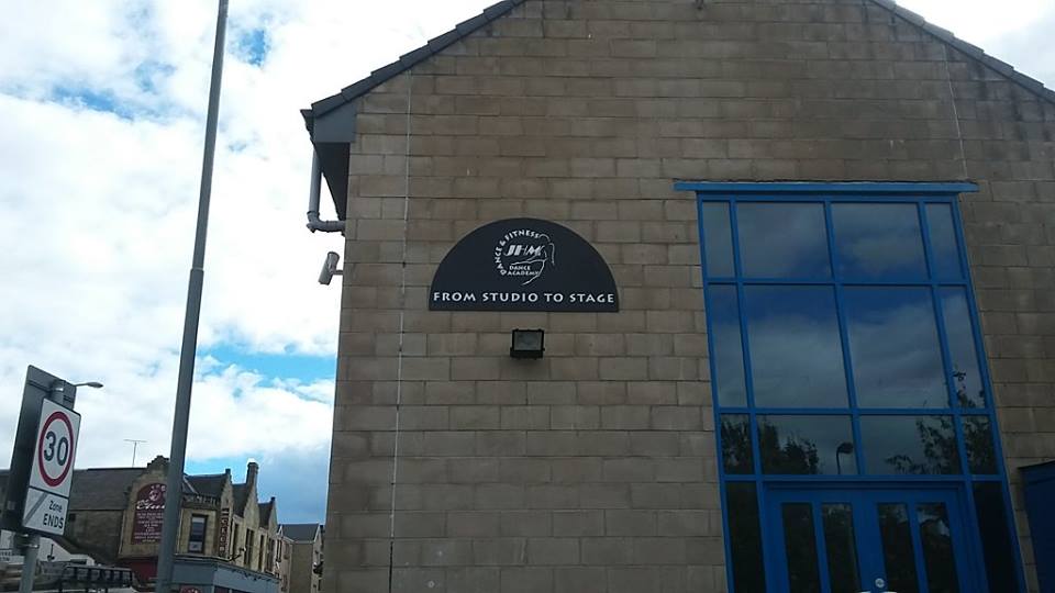

    I agree – it’s perfectly feasible to do this with a jigsaw. Just cut the shape in vinyl – apply it to the board – then very carefully follow the shape with a jigsaw. You may get one or two slight irregularities but it is perfectly feasible to do it this way and the result is totally acceptable. I have a small CNC table but am limited to a maximum width of about 480mm so anything bigger than this gets cut out by hand with a jigsaw. I’ve done it with shaped sign blanks as well as flat cut letters with perfectly acceptable results. It may not be quite as perfect as a CNC cut – but is perfectly acceptable never the less once the edges have been sanded smooth.
    Here’s a few I’ve done using a jigsaw:-

    No disrespect Phill but my clients wouldn’t accept "Garden Shed DIY" working practices. If I can’t make it myself with the equipment designed for the job, then I outsource to companies that can. Each to their own, and complete respect to you guys that can produce work by those means, but my clients just wouldn’t accept it
    October 13, 2016 at 7:47 pm
    Well Stuart has asked for advice and has received a number of well meaning replies. I guess it’s a subjective decision to decide what is and isn’t an acceptable way to produce a sign blank. Perhaps Stuart might like to give it a go for himself and then decide whether or not the result is acceptable?
