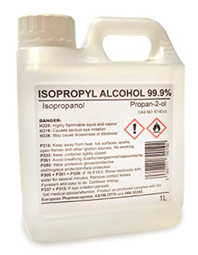

    No. You will need to use Wax and grease remover first – then alcohol after.
    February 7, 2022 at 9:25 pm
    Definitely advise against them waxing the vehicle, prior to installing vinyl.
    As has also been said, wax remover with a micro-fibre cloth, followed by Isopropynol alcohol.

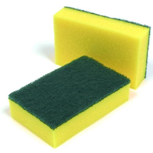

    “IF” your graphics crosses a recessed area of any sort. clean in the recessed area with one of these “domestic” cleaning sponges with a soft scouring pad. better if it’s a bit worn already.
    use this with your degreaser/wax remover in the recess, then again, follow-up by cleaning with microfibre cloth with Isopropynol alcohol.
  • Jeff
    February 8, 2022 at 7:44 pm
    abrasive sponge. good tip rob!
