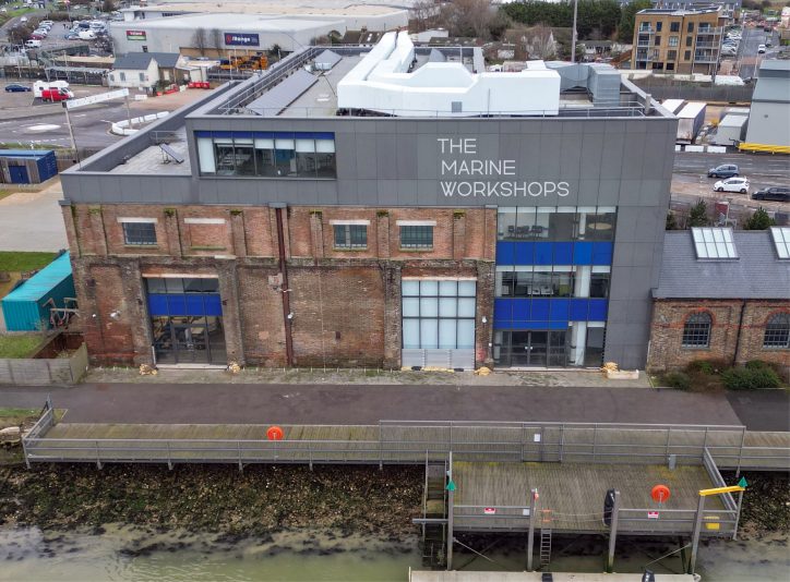

    Hey guys,

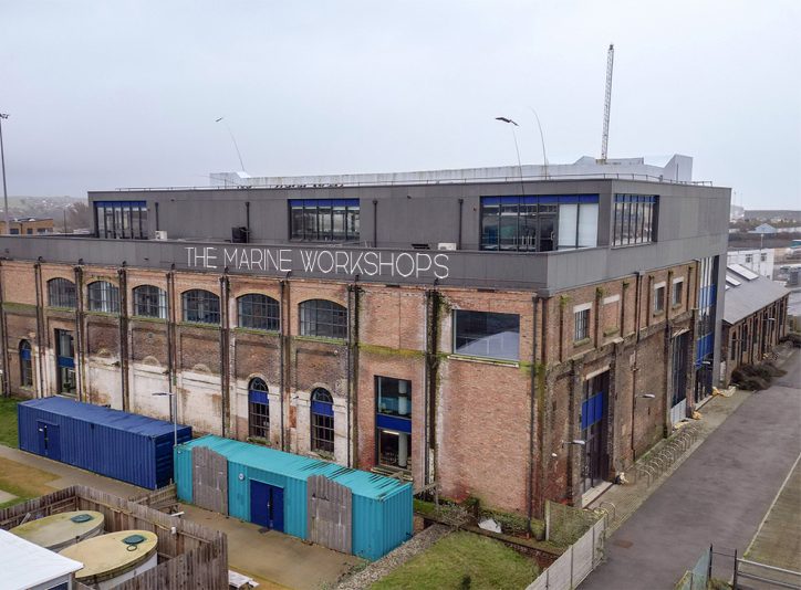

    One of my larger clients has asked me to look at supplying the signage as in their mocked photos (attached), while I have installed small trays somewhere near this height, I’ve not installed what I imagine will be built letters (we haven’t discussed whether illuminated yet). I don’t think I’d trust any kind of push-fit locators at this height and size of the letter so I’m discounting flat-cut compo or acrylic for the time being. Ali with welded locators may be an option but won’t be fun trying to do all those brass fixing up!
    Does anyone have any images of similar work they’ve carried out at height, ideas and methods of fixing? I’m due a site visit next week where I’ll have access to the terrace and roof, so I’ll have a better idea of what the cladding is then, but I’d like to take some ideas with me.
    Personally, I’d like to make up a box frame on the terrace and roof, with letters attached to that, negating the need for what will be pretty serious access plant/equipment, and hanging off of said access equipment, but it would be nice to be armed with some options.
    Budget generally isn’t a major issue with this client, it just needs doing right, and this is a little out of my comfort zone, with regards to the secure fixing of such letters. particularly on the side of the road, where there looks to be pedestrian access!!
    Oh yes, the quayside location so needs to be a decent material to cope with salt corrosion.

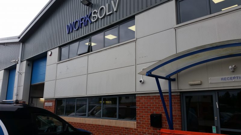

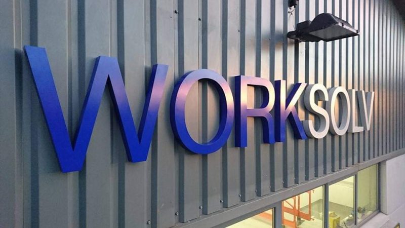

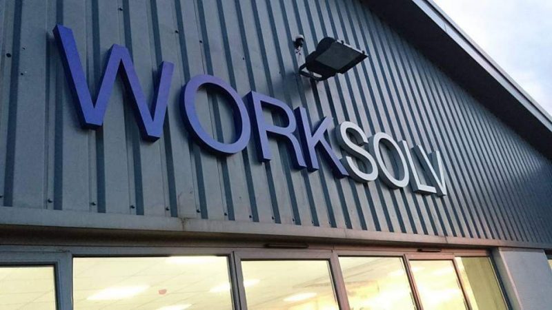

    We have not long ago installed some built-ups aluminium letters, they have 19mm back trays, and they were fixed with long tech screws through the face of the foamex to cladding, then the letters were fixed through the returns with small screws into the 19mm, worked well.
    June 22, 2023 at 3:53 am
    Done these previously as Gary said using a foam PVC back fixed onto the cladding then screwed through the letter in the side.

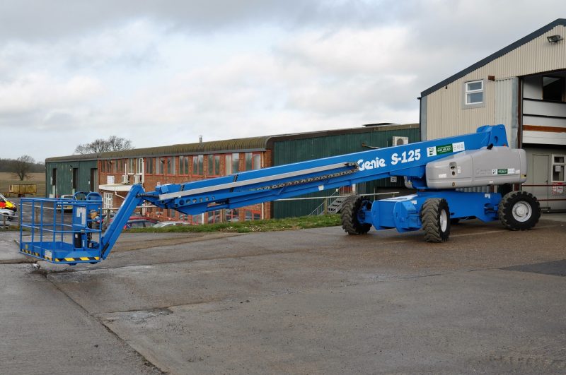

    Cherry Picker
    I always prefer a rough terrain cherrypicker with an articulating boom. But based on the height and distance the signs are at, particularly the one on the side. I would advise on a stick boom cherry picker with a reach of 30 metres at least.
    Again, the supplier of your machine will best advise you on this, if you can give him the height and the distance of stretch for the side letters.
    Get a quote for one, three and a five-day hire. I only say that because it can sometimes be more cost-effective this way and you aren’t under pressure should the job overspill onto a second day. Something you should allow for in your quote.

    June 23, 2023 at 1:39 am

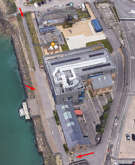

    I located your site on Google Maps.

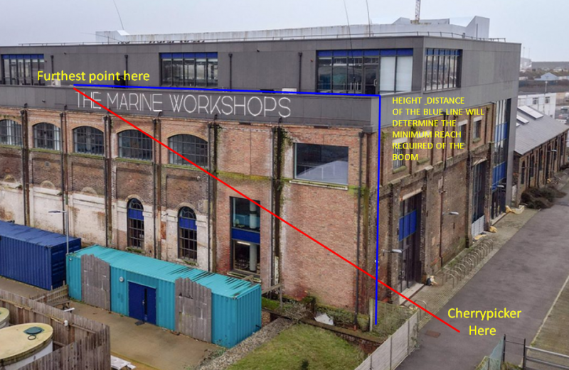

    You can see two entrances for the cherry picker. It is always best to measure the gate width to make sure turning into it with a cherrypicker is possible. The last thing you want is a low-loader and cherrypicker on the back and it can’t get near the site. a sore hit in your pocket for nothing!
    I imagine your customer maybe have all the building dimensions if it is a new build renovation.
    If not, the fact you have access to the roof is very helpful because measuring the distance the furthest away letter is on the side and the height of the area at the front can easily be done on the roof terrace.
    give the cherrypicker company them or work it out yourself, the “minimum” length the boom needs to be.
    A word of caution, there is a sort of levitated Boardwalk alongside the tarmac from of the building.
    Your cherrypicker “must” not sit near the edge and never on top of it, even if just turning. The weight of these machines could easily collapse the boardwalk and topple the machine with your men in it.

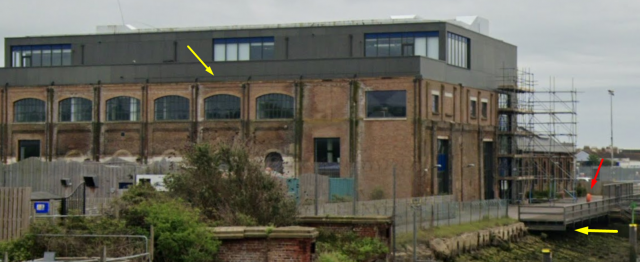

    June 23, 2023 at 1:46 am
    Arrows:
    You can see from this picture, just how high the sign is when you take into account the guy in the high-viz jacket shown and the scaffold is six tiers high and will require a seventh to do the front side, but would be useless to access the side. Hence why I would advise on the cherry picker.
    You can also see that there is “nothing” under the Boardway. So I would Cone this off while the cherry picker is in operation. Not just for the public but to keep it in mind for the machine operations.
    If you look closely where the arrow on the roof is pointing too. There appears to be a pipe or something where the letters need to be fitted. Just to make life easy for you! 🤨

      I will see what we have around here in the way of installation teams. I was tempted to go with a wrapped scaffold, rather than a cherry picker, purely because even on a reasonably nice day it is windy up on that roof, also it costs no more to have it there for two weeks than a few days, so inclement weather shouldn’t be an issue, but I can see which the installation team prefer.
      The side with the containers may be problematic, it’s mostly just grassed over beach cobble/shingle, outside of those containers, There is some concrete but access is limited with a cafe now occupying some of that area where those tanks are shown, I don’t think they were there when I visited yesterday.

    I was looking at the picture of the size of the man in orange next to the building and scaffold and shaking my head thinking, no way! 😳
    Best of luck Hugh, very brave working that high up, i hope you get the job and it all works out great.
      June 27, 2023 at 3:24 pm
      Thank you!
      I’ve roughly scaled it to around 16m max working height, can’t say I’m overly comfortable on cherry pickers, much prefer scaffold, but I’ll get an installation team to do this I think, just saves loads of hassle!

    Not much to add on top of the other comments but if we were doing this, and you had the space, we’d most likely go for a truck mounted boom. With the distance you’d be coming in there’d be much less ‘bounce’ when you’re in the basket.

      June 29, 2023 at 1:55 pm
      I’m chatting to the access hire people later today, hopefully they have something suitable!
