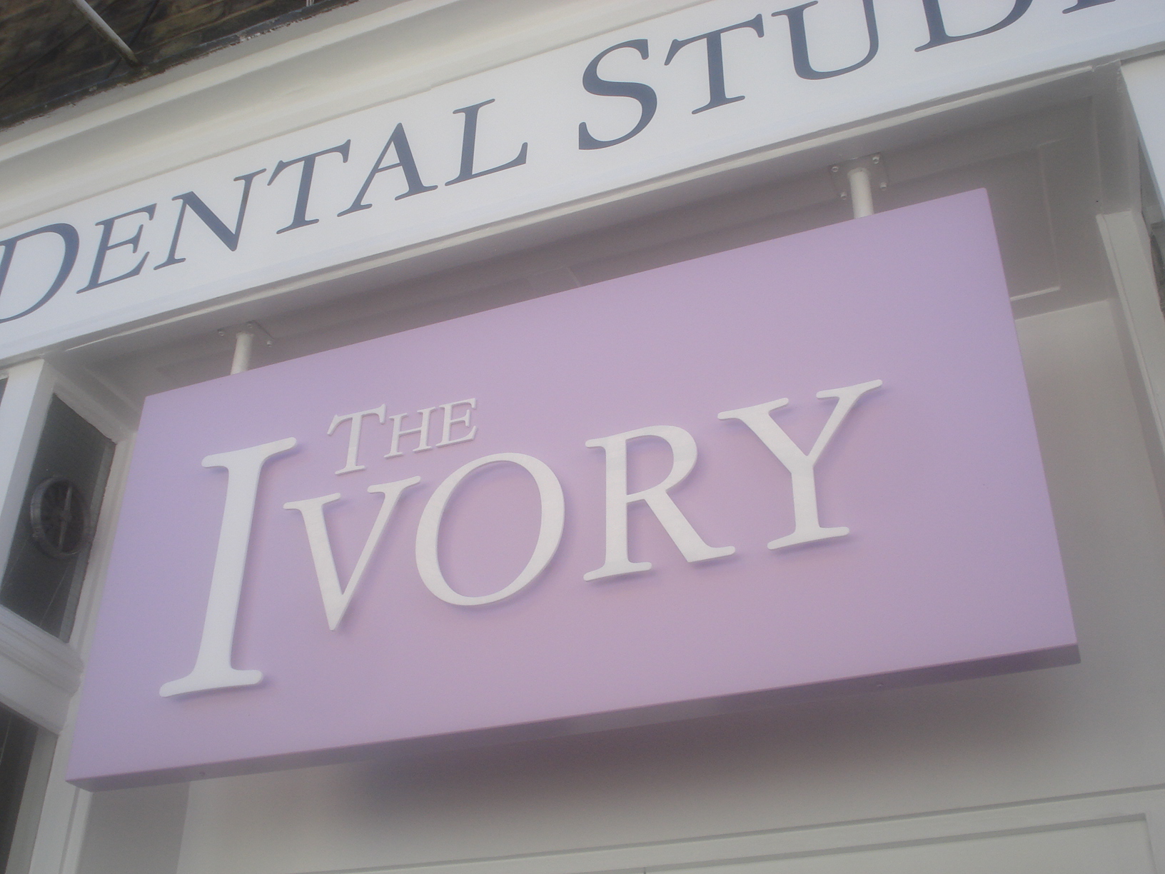

  • Alan Stuart
    July 29, 2008 at 1:25 pm
    cool stuff !!
    The Ivory sign is a really nice pastle-ly purple,
    is it a powder coated tray?
    And do you weld up your own hanging brackets?
    Its all very neat and effective

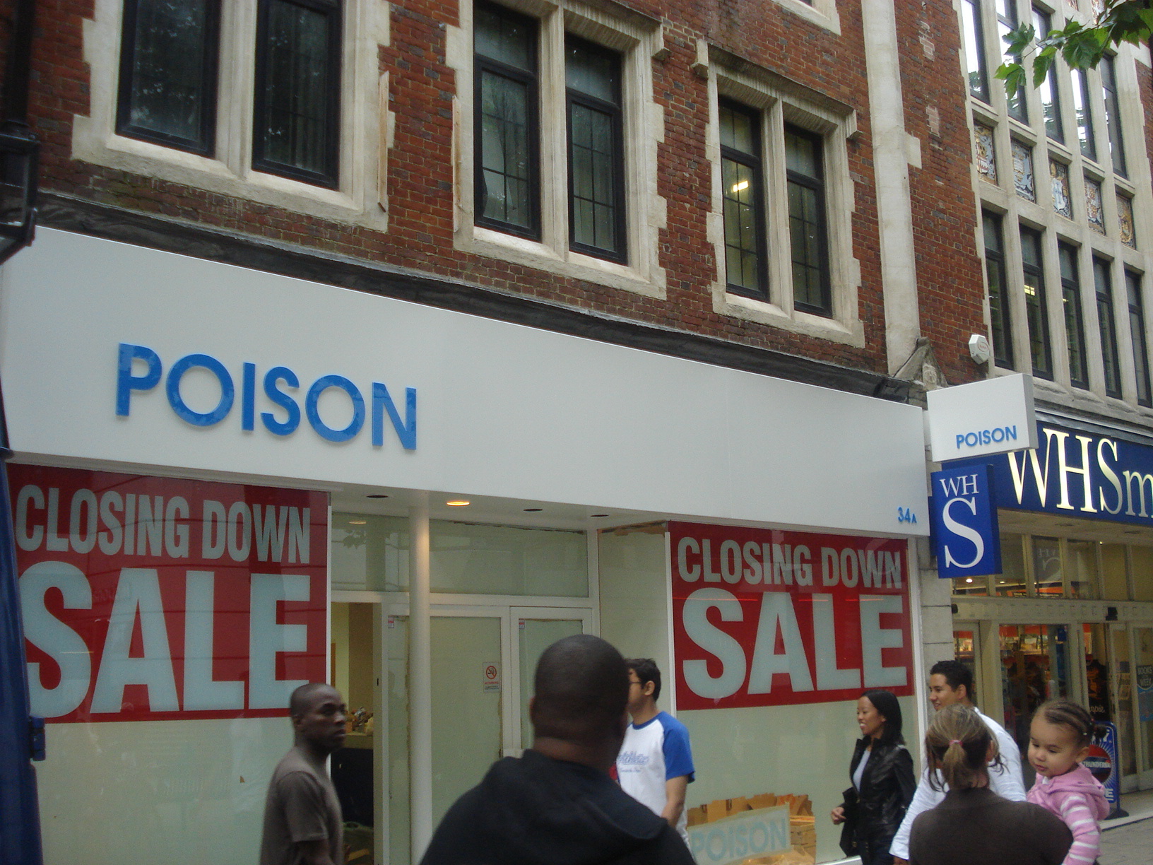

  • Peter Mindham
    July 29, 2008 at 5:44 pm
    Really nice stuff. Hope they weren’t closing down after you made the signs 😀

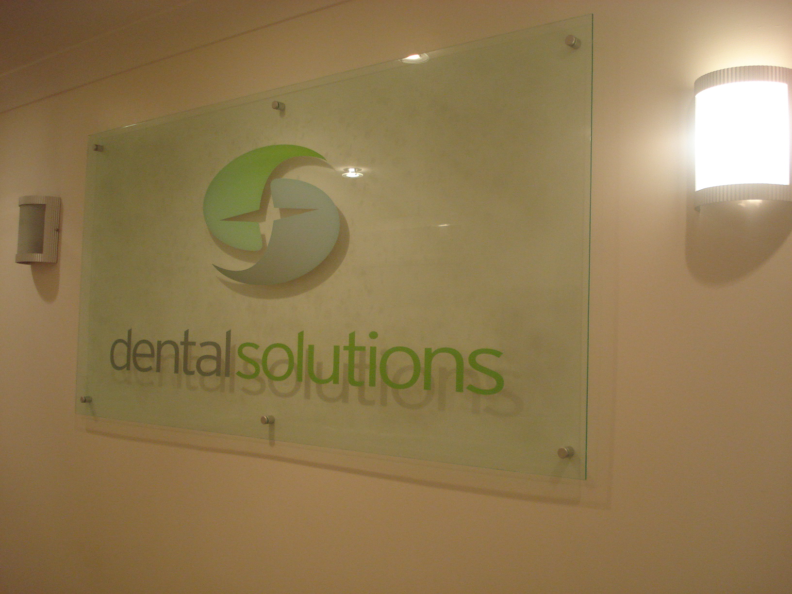

  • Simon Polakof
    July 30, 2008 at 4:54 am
    Hi Mate!
    Great work! Did you us plexi material or glas for the Dental Solution job?

    The ivory is powder coated aluminium tray over an aluminium tray mounted onto steel drops with welded fixing plate. We subcontract out the steelwork.
    Dental solutions was green glass look acrylic with reverse mounted digital print – there is a shading on the logo which looks better in real life.
