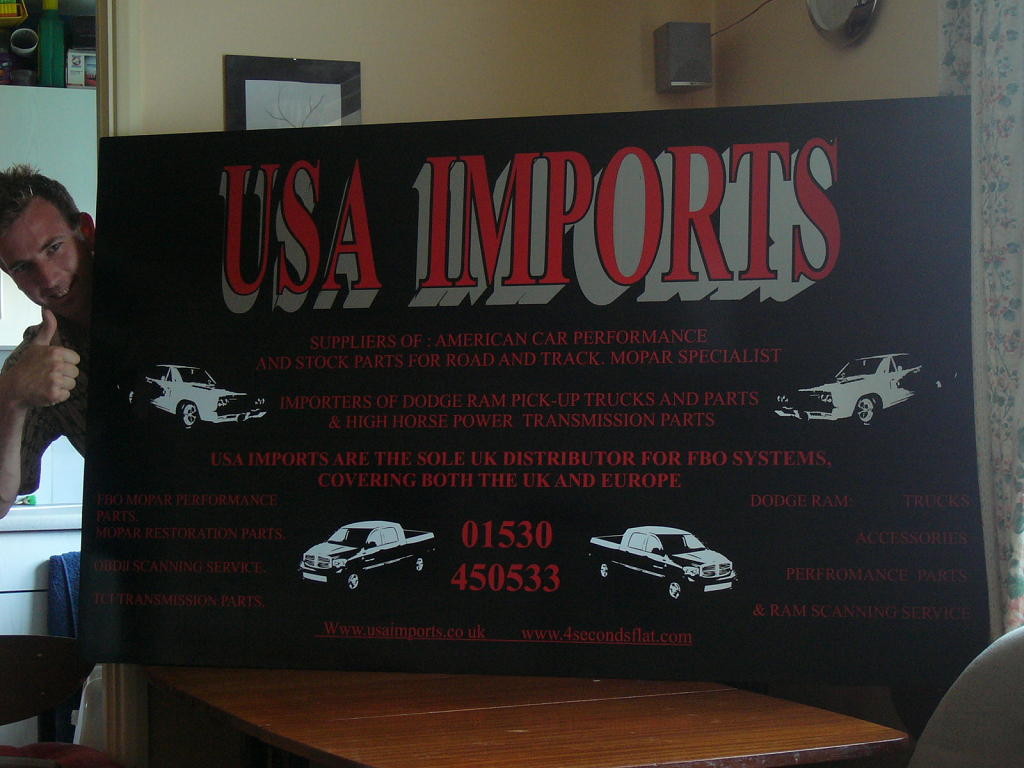

5×3 ft, 10mm pvc board, flood coated in black oracle 651 – 3 panels with 10mm overlap-, i even did it dry… first for me !
red text applied with a mist of app fluid, shadow too (have since rectified the faulty shadow in the pic !), white road runners and dodge ram trucks were my own vectored images,
i was initialy worried how red would stand out on black, but even from 10 ft away it’s legible !
used two real handy tips on this job,
first was the vectorisation of the cars and trucks, handy tip from another forum got me going there, turn a bitmap into a one bit lineart image, trace with corel trace as ‘clipart’, and save ! 2 minute job ! takes longer to find a decent clean and uncluttered image than it does to make and cut,
secondly was that real cool tip from here the other dy, usung builder chalk to highlight the weed lines on white vinyl, saved me at least 20 mins by my reckoning ! cheers !
