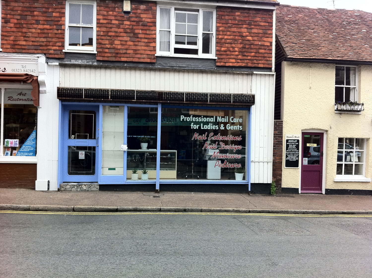

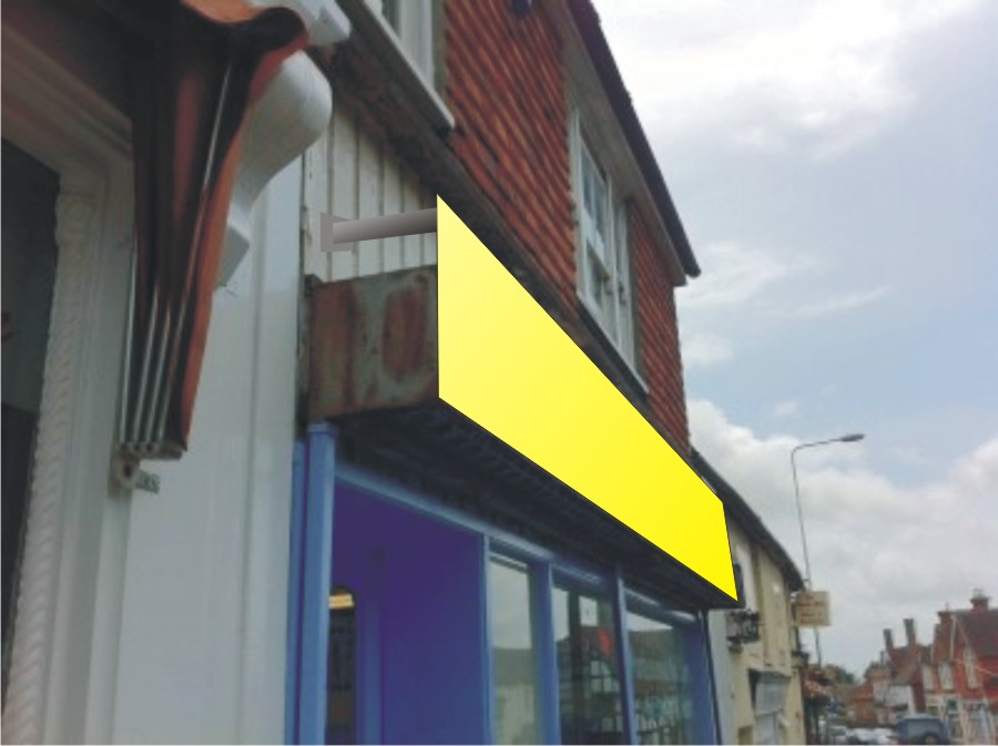

    Hey guys, got a large tray to quote for,
    if you look at the pics, the previous sign (which blew down well within a year) was fixed to the security shutter and this just isn’t suitable.
    I suggested to the cutomer that we put a trap up above the shutter on the white facia but the customer has requested that we cover the shutter.
    my first thoughts were for a large pan with a 340mm return, which slides over a framer built above the shutter,
    is this how you guys would do it?
    thanks in advance,
    Hugh
    transparent yellow is the proposed tray (pan, whatever)
    the black frame seen underneath,
    foamex letters to exterior – though i think these need chucking for something nicer.

    I can’t see a problem with that Hugh,
    Just pretty expensive, are they up for paying for something like that, before you spend time finding quotes for frames etc.
    Also does the sign need to go to the end, may look better finishing where the windows end, or is it me 😕
    Always a difficult one when there’s a deep shutter box.
    You can usually fit a standard tray/sign above and cover the box in the same material, but with the fascia being so shallow I don’t think you would see the sign other from across the road.

    HI Martin,
    I don’t imagine it does need to go to the end to be honest, not sure why I did that!
    is there a better / cheaper way to do it? i’m no sure if they have a budget in mind, perhaps i should have asked, i’m guessing the last sign was cheap (10mm foamex letters, some sprayed red, small / few locators, fixed only to shutter cage).
    my first thought would be to get the local scrap guys in to remove the shutter, then use the whole facia with a nice simlple flat clad composite face or pan sign, letters then attached.
    I’m not certain my idea was the best, well, it’s solid and would look well finished but… ???????????????????
    thanks,
    Hugh

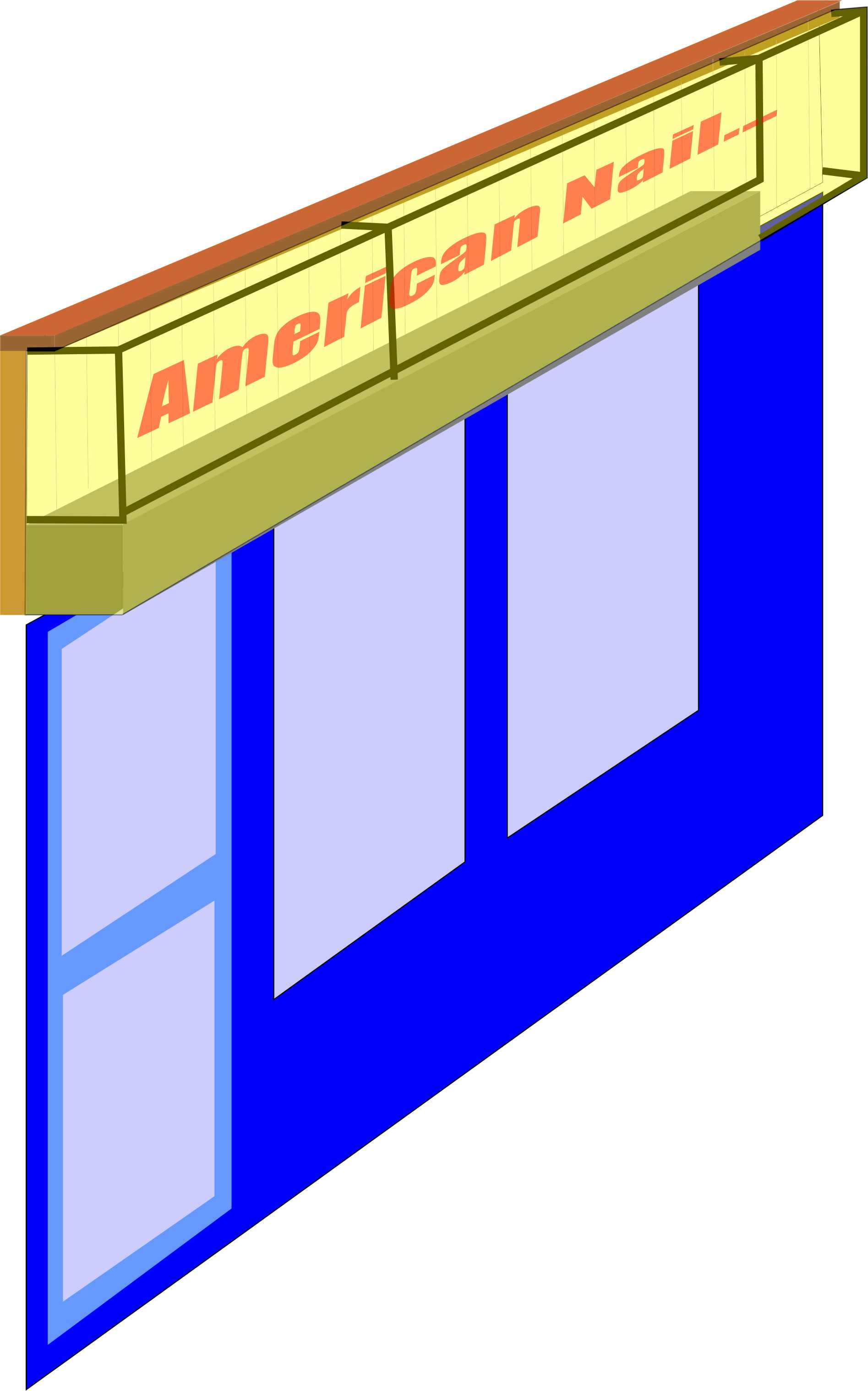

    I guess another way Hugh is to apply a plywood backing to the face of the box making it taller and running some brackets from the rear of this to the fascia behind and then use a frame and panel sign on the ply.
    then paint the edge of the ply to match the frame.
    The only problem I see is getting a good fix to the box frame..it doesn’t look the best structure I’ve seen.
    something like rough pic below
    then again as you mention if they don’t use the shutter tell them to get rid of it…..problem solved :thumbup2:

    i’ve decided to quote as per the pics attached,
    i don’t need a box frame, just a top and front so have got a couple of local fabricators coming back with a price tomorrow hopefully.
    just hope someone can make the tray!
