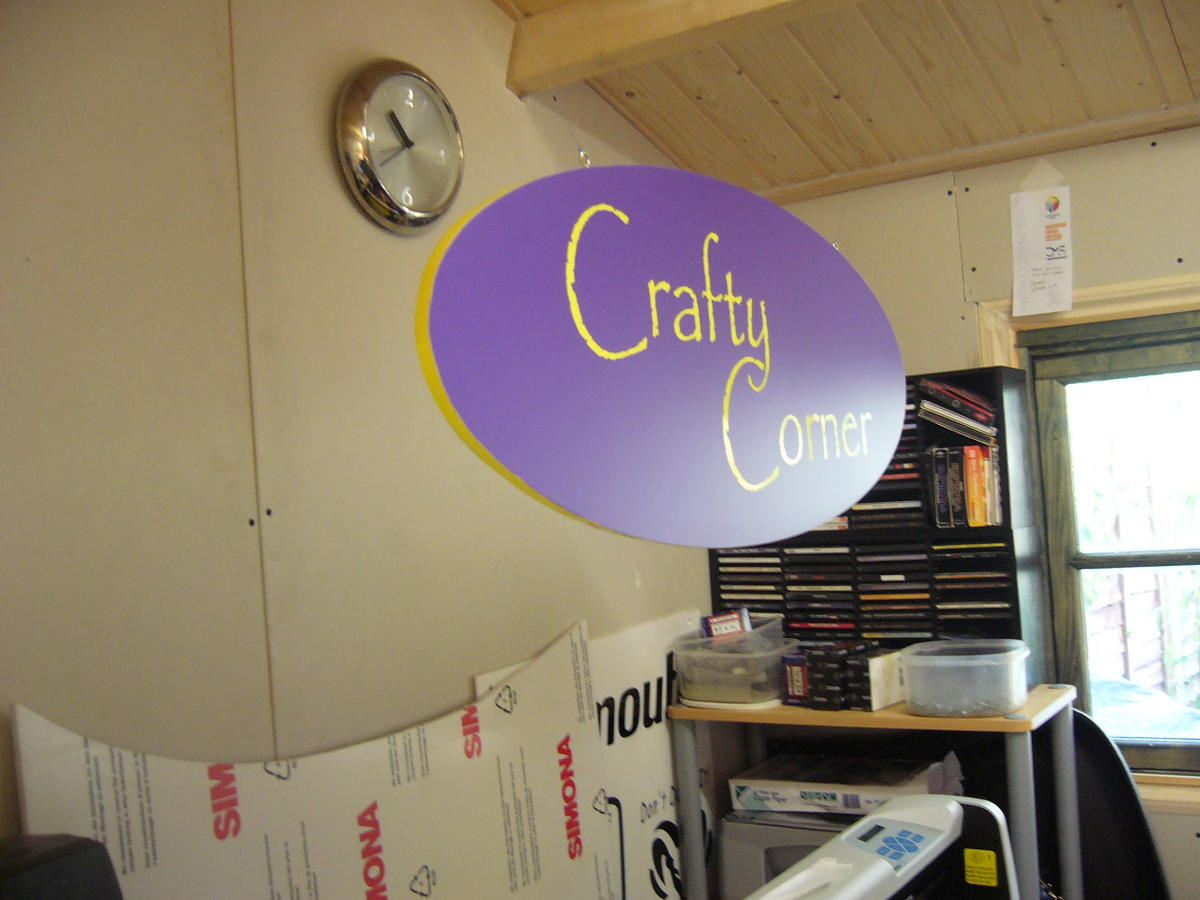

    well as the header suggests, this is a quick internal shop sgn i did on monday morning,
    about as basic as a sign could be i guess, but it was new to me to actually be cutting a shape !!
    cut using a jigsaw ( fine tooth metal cuting blade ) and a cut vinyl template as a guide,
    900x300mm, made from 10mm pvc board and supported with 40lb fishing line !
    purple is ultramark matt, yellow is 651 gloss,
    really basic i know, but it’s my first shaped sign !!!

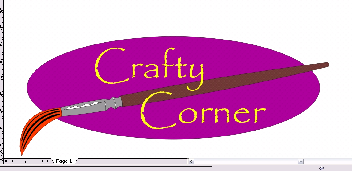

    he didnt know what he wanted to start with, other than choosing colours and dictating the font, so my orginal design incorporated my own re-drawn paint brush, eventually he decided on the finished item as seen here,

    different view, for what it’s worth !

    he wanted the sign, originally, to kind of ‘point’ to the corner of the shop where the display is set up, arrows etc looked naff, so i came up with the brush, only took about 15mins to re-draw it from a bmp image i googled, would not have been the simplist of things to cut and put together, but i was more interested in just doing it !
    Jayne, i think the purple is ultramark, but yes, it is matt finish, the yellow was gloss, the ultramark doesnt weed brilliantly so i decided against using the matt yellow on this font !
    ps, it’s double sided too as the display is in a bay window, looks quite nice as it’s lit from above.
