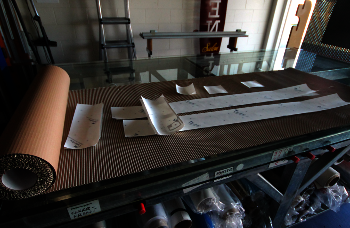

  • Simon Worrall
    March 26, 2016 at 5:04 am
    This is how we do it.
