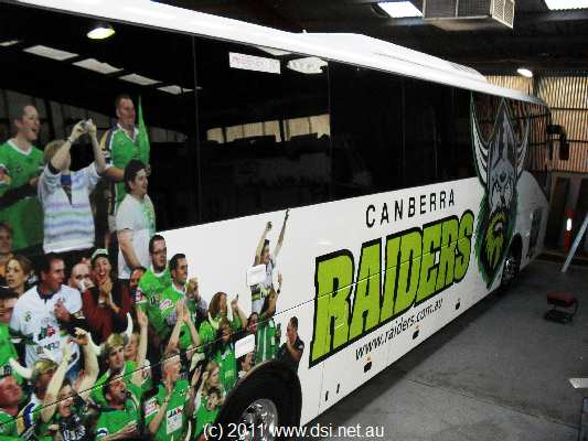

    Love the "Raiders" bus – looks really well balances and the size makes it very striking

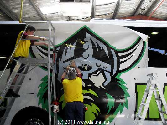

    Is that your father applying the side of the bus 😉

    Everything was done dry, except the window decals on the raiders bus. My son and I had to work off ladders, so doing the windows dry was going to be a nightmare.
    The raiders bus measured 15m long x 3m high. I laid printed sheets on the bus, and hand cut around all the graphics and text.

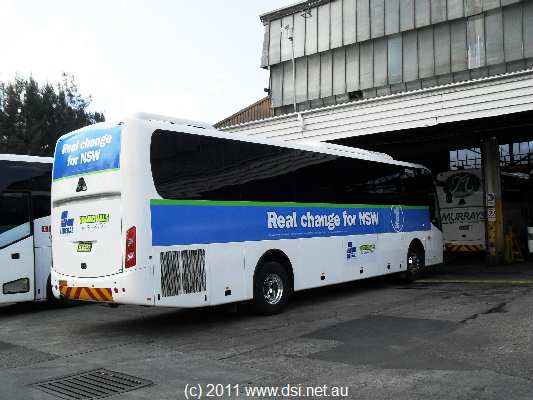

    The "Change for NSW’ buses were babies in comparison, 2.4m x 10m. I did the sides in two panels (5.5m each) on each side, hinged from the top, and dry.
    All jobs were 3M IJ40c

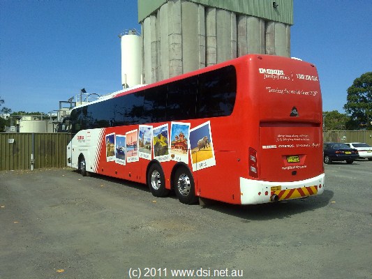

    This globus bus I did wet (sorry rob) but it was a huge job and the dry application was just asking for trouble. Used a full roll of 1220mm 3M Red on this one. Then we fitted the printed graphics, and hand cut the strips.
