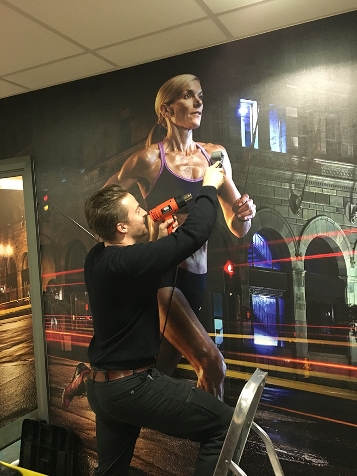

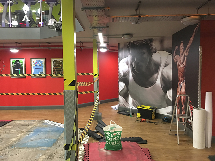

    March 8, 2017 at 11:11 pm
    Hi guys, haven’t posted on here in ages. But i used metamark wa a while ago and was great!printed on a roland sp540i 🙂

    March 9, 2017 at 9:03 am
    Hi Ben,
    Like the images, i also have been using Metamark Wa. I noticed your using a heat gun in the first pic on the overlap any reasons why?….cheers mate

    quote Ben Hansen:
    nice work Ben!

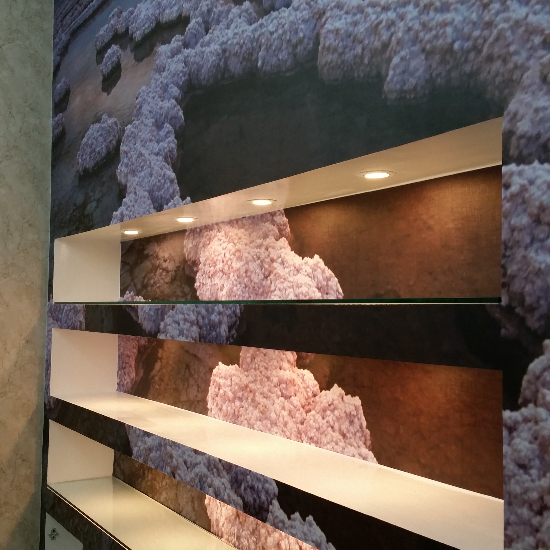

    March 16, 2017 at 6:17 pm
    Installed this today. Customer didn’t OK the quote till yesterday, so dashed round the corner to pick up some media, ended up using Avery 8726 Canvas high tack wall covering.
    Really thick, sticky adhesive which had me really worried about installing, but it worked a treat.
    Need to call back next week to install some flat cut lettering.
  • Joe Wigzell
    March 17, 2017 at 9:29 am
    Nice…like the depth through the shelving
  • Dan Osterbery
    March 17, 2017 at 9:32 am
    Looks great David! Pat yourself on the back
