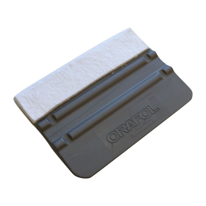

    I agree the blue Avery are good all rounders mate, but they have changed that felt edge on the blue ones three times in as many years and still haven’t got it right. I am a keen Avery squeegee user for general sign work and wrapping, currently have 3 types always in my box, however my favourite one at the moment for general sign work has moved to the Grey Oracal Squeegee with White felt edge. lasts 10 times as long as the Avery blue, though admittedly i prefer the blue nylon side a bit more than the oracal grey. the oracal ones are defo worth a go!

    I would imagine either Europoint or Spandex will have them as both these companies are the only two "official" suppliers of Oracal media in the UK.
    How are you finding them them so far Rich?
    Initially the felt will feel a little thick in comparison to general squeegees but they feel fine after a short use of your first one. The thicker felt also accommodates multi-layer vinyl application better and prevents the typical ring of tiny bubbles that can often be left around the perimeter of "double+ layers" of vinyl graphics if using a nylon squeegee or thin felt.
    NOT saying this happens with the Avery nylon ones, but often does/can if they are quickly worn out which is the downside of the Avery felt squeegees and others for "general sign" use within workshops.
    The 3M gold squeegee has to be the best nylon all round squeegee and adding felt to one side of these squeegees does help create same. but the nylon blade itself is pretty sharp so you quickly end up cutting through the felt due to the nylon blade.
    if you are buying separate adhesive felt strips on a regular squeegee i would advise blunting one side of the squeegee before wrapping in felt as it slows down the wearing process on its sharp edge.

    Ok after few days I have to say I really like these, I like the amount of flex and they feel a little smaller or more comfortable to use, as Rob said they start off a little thick and can be an issue when putting vinyl into door shuts as most these days are very tight, overall a great squeegee [emoji6]
